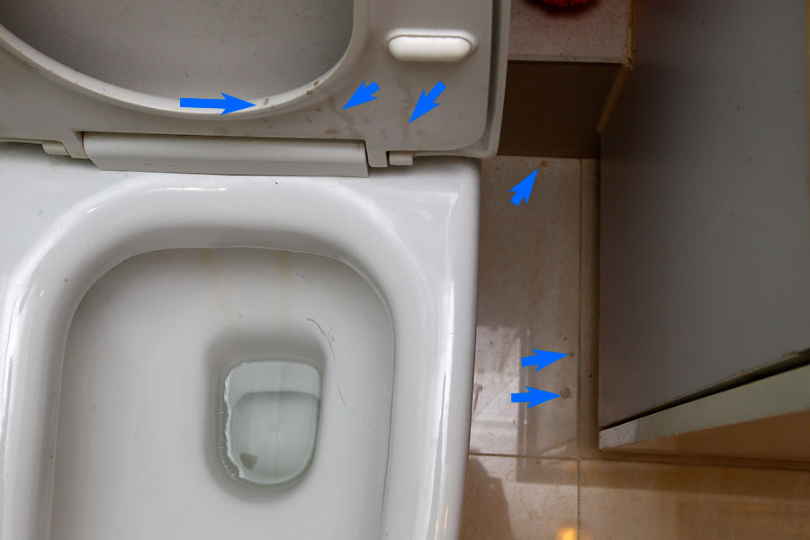

as a drop of C-41 color developer appears nearly colorless on sink, it doesn't show up until it dried and chemically changed to dark stain. I recently processed C-41 in my bathroom and the stain showed up the next morning on my toilet seat and floor tiles.
Can any expert provide advice on removing them? Thanks a million!:munch:

Try 28% Acetic Acid. Use rubber gloves and wash the areas well with water afterwards.
The stain is oxidized developer, which is soluble in acid.

Mick, a color developer is different than a B&W developer. Acid can only remove Metol stains in the case of B&W developers, and to some extent, phenidone stains.
