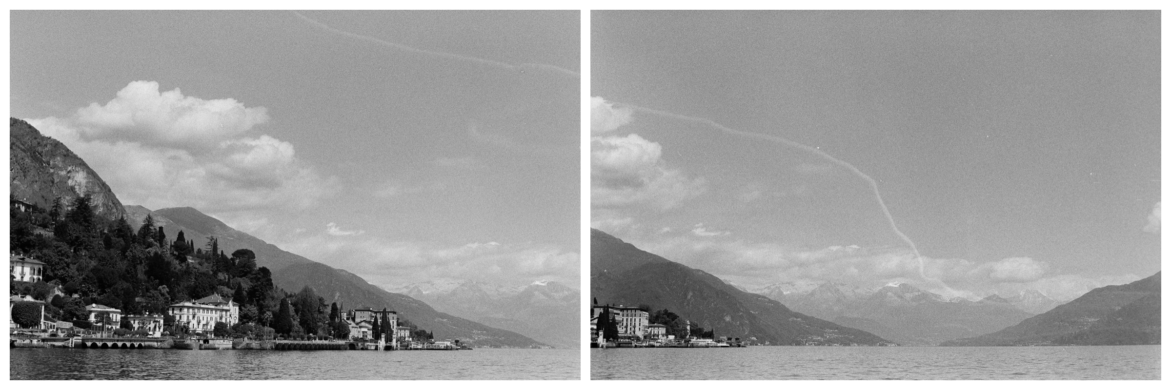

Hi all,
I recently developed some film and discovered a strange aberration that I cannot explain. I've been developing my own B+W film for 4 years, and I've encountered this issue twice now. Different film stocks, different camera.
Here are two consecutive frames from a roll of Ilford HP5+ processed in Ilfotec-HC using the standard recipe from Massive Dev Chart (I also used Ilfostop Stop Bath, Ilford Rapid Fixer, and PhotoFlo as my rinse aid).
As you can see, there appears to be what *looks like* a water stain across both frames. But when I look at the negative, tilting it to catch the light, I can't see it on either the glossy side or on the emulsion side. It seems to be embedded into the emulsion. If I view the negative over a light table, I'm able to see the dark stain as if it were part of the image. I've tried gently wiping both sides of the negative with some PEC-PAD photo wipes to no avail.
Does anyone know what could cause this, and how to prevent it?
Thanks in advance!
Joey
It could still be a water stain, even if you cannot see it on the surface on either side.
Try re-processing the negative by doing a distilled water bath at normal developing temperature, re-fixing and rewashing the negative with photoflo in distilled water. It might go away.
I often see this on motion picture film that didn't have the water removed sufficiently by the vacuum squeegee just before it went into the drying cabinet. We simply run the roll back through the processor once more and it tends to go away. The squeegee on our processing machine is a temperamental thing...
Thanks so much, Kino! Any suggestion as to how long I should leave it in the distilled water bath?
It looks like a photo flow issue, if its on the base side it will easily wash off , if on the emulsion side not so easy - I would use room temp distilled water and gently try a very soft cloth on base side to see if it comes off.
This usually is a result of the photoflow being too concentrated, are you mixing the photoflow in distilled water?
You may be on to something, as I think this time when I added the PhotoFlo, I didn't do my usual mild agitation to distribute it throughout the tank (I was interrupted at the end of the process). I'll have to remember to be more careful about this. I never thought it could be the PhotoFlo itself. Thanks for the tip!
About your normal development time and temp; need to let the emulsion re-swell to allow the stain to migrate out. Good luck!
BTW: it IS photoflo that is causing your problem. If the simple fix Bob suggests doesn't work, try what I suggested...
Rather than use drops, take the time to follow the instructions and store any excess solution. This is a much better way to go.

If you live in an area with hard water, it may be a mineral deposit. If the above remedies don't work, try a long soak (~10 minutes) in stop bath and then rinse and soak for a few minutes in distilled water/Photo Flo.
Photo Flo only takes a few seconds to do its work, but if you need to get minerals out of the emulsion, it's a good idea to extend the final rinse in distilled water/Phot Flo to a few minutes (3-5) to ensure that enough of the minerals diffuse out of the emulsion.
And do try to mix the Photo Flo at the recommended dilution or a bit less :smile:
