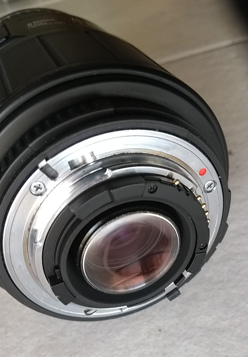

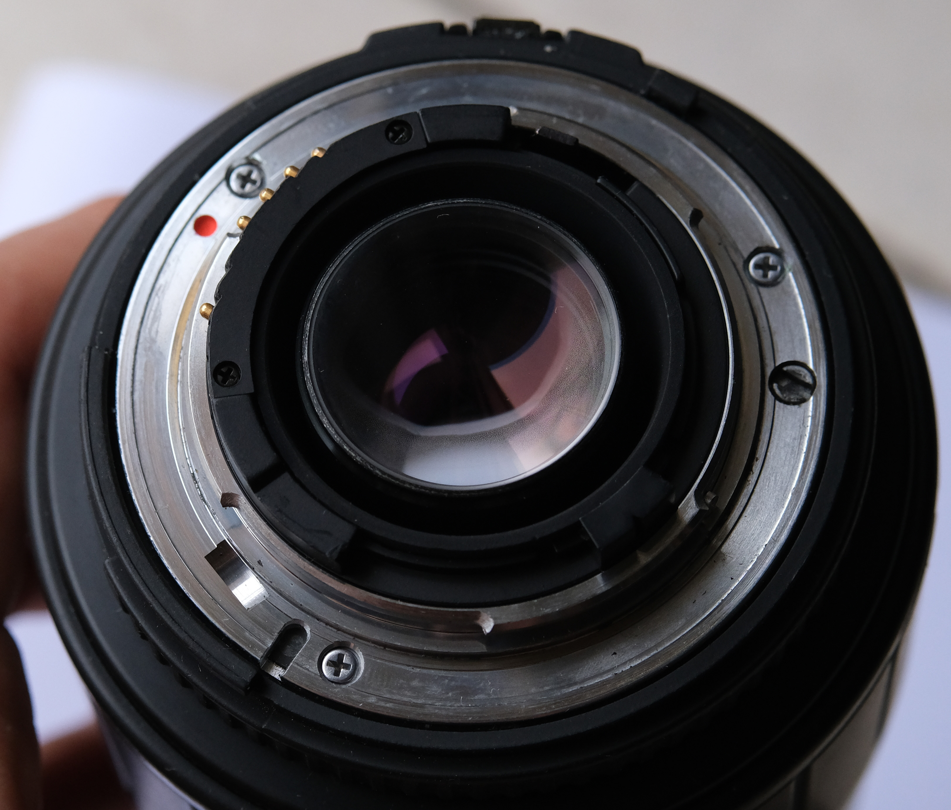

What is it?
Could it be cleaned?
Does it affect the image?
xkaes
Mar 25, 2006
4,791
Colorado
That's an inadequate photo for evaluation. What should we be looking at? We need a closer shot with an arrow or description of what is the "stain".

and take the lens cap off so we can also see through it. Show some pics at different angles too

hard to tell but it kind of looks like separation to me in a crescent from 1 o'clock to 7 o'clock.

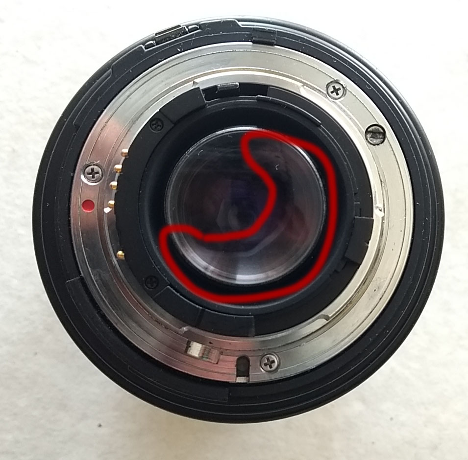

Hello, thank you.
It is a lens I want to sell. It is an “inexpensive” Sigma zoom lens, but I could sell it for 100-150 dollars if it is in good condition.
Tomorrow I will try to take more photos without the lens cap.
But I guess the stain is more visible with the lens cap because there is more contrast in that way.
The photo above is with direct sunlight, and we see texture in the stain. But usually, with a softer light, the stain looks more like this:
And I read the word “haze”… could this be haze?
I don’t know if it is separation. I just saw a video and learnt about separation. I can say that I don’t see rainbow-like colors… Tomorrow I will look better.

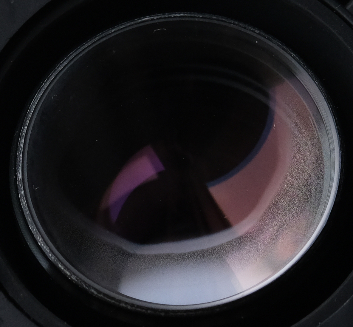

You would need to disassemble the lens to determine of it is just haze that can be cleaned, or if it is permanent damage to the glass. With this defect, it will only sell for a fraction of what it would normally sell for. Having it professionally cleaned is more than the lens is worth.

It's paint loss (propably never thoroughly painted at assembly) used for the interior flocking. Won't affect anything.

Sometimes lens element separation that looks very reflective at a glancing angle has little effect when viewed straight-on, as image forming light passes through the lens. Sometimes it is highly visible face on and then it is likely to scatter light and cause reduced contrast and increased flare. So for example, the second to last picture straight on with the red circled area concerns me more than the last picture. But either way, the lens is not in "good" condition so you would have to try it and/or pass it on to someone who likes to experiment.

Exactly. It may or may not be a problem -- so test it. Also, it may or may not get worse in time -- so I'd dump it.

I will go along with balsam separation as well. If you look at the lens with both caps off with the diaphragm blades open and shine a directional bright light through from the front to the back or back to front, you may also see quite bad haze (like a foggy veil) with a halo, or what look like swirling cleaning marks which are not visible without the light.
How do I know this? Well I have just had to condemn a Nikon 35/70AFD F2.8 lens because of this which is irreparable separation.............Oh yes it can be repaired......but the cost which will be more than the lens is worth. It will be cheaper to buy another. (If I can find one)

Hello. Thank you for the comments!
So, it seems that most people think it is about separation.

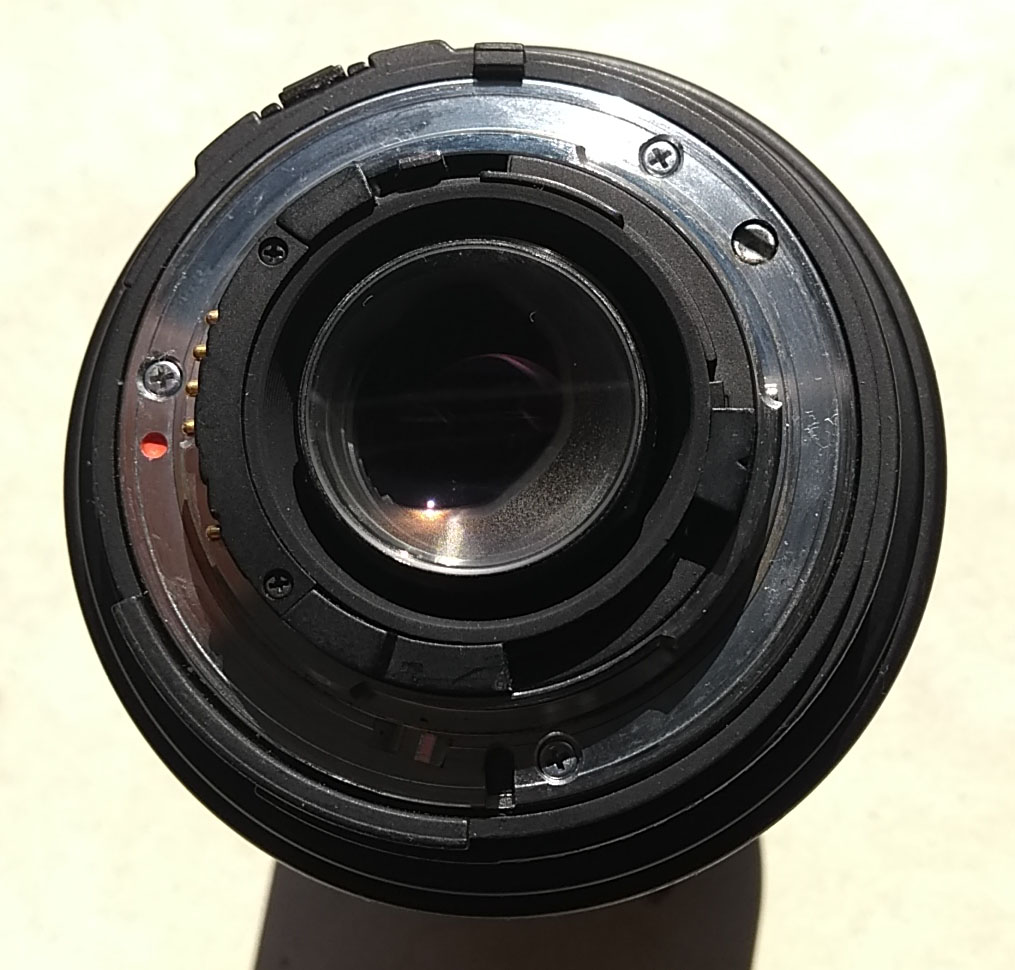

Here are other photos:
So basically, repairing this separation is very expensive and it is not worth the money considering the lens, right? Anyway, I could ask a lens repair service in my city.
And does this separation progress gradually or it always stays like this?

That's a much better shot.
It doesn't matter if it is separation or fungus -- it's NOT worth fixing or using. And no matter what it is, it's going to get worse anyway.

It appears that with that lighting there are no artifacts. Now check it in bright sunlight and with bright sunlight coming directly into the lens.

One factor that needs to be considered is the aperture of the lens for the photo. Wide open the results would be worse compared to stopped down because the problem is worse on the edge(s). So if you always stop down the lens, it might be usable -- but the separation or fungus will get worse and worse over time, and so will the results.
But if you were always wanting a soft-focus lens, keep it, and use it opened up.

Looks like separation; also I don't think it's very hard to take off the bottom element. You need a rubber opener but it could be cheap. Like 25 dollars US.

It actually looks like separation and dust (or a pre-fungal haze) (which could be just dust (but might turn into the snowflake or super fine hairy fungus- as dust is how fungal spores get in there and would then bloom with just a trace of moisture? that's my understanding-please correct me if I'm wrong-anybody )
In high school(before digital) I worked the counter at my local camera repair shop (which was reputable) they would not have been willing to uncement,clean and recement that group of elements in an off brand lens, If they would be willing to try it with a holy-grail(rare and expensive) lens it would have been at the clients risk
if you're looking to sell, it's not worth much and the market is way down, if ebay is an economic indicator, things don't look good.
It could produce a beautiful flare(at the magic angle of incidence-that is both BS and true- with an image that shows motion (or a second flash curtain sync)-techniques I have seen successfully at a critique, but the practitioner was tight lipped as to the process-basically they were stunning images (and I wanted to be able to do that)
