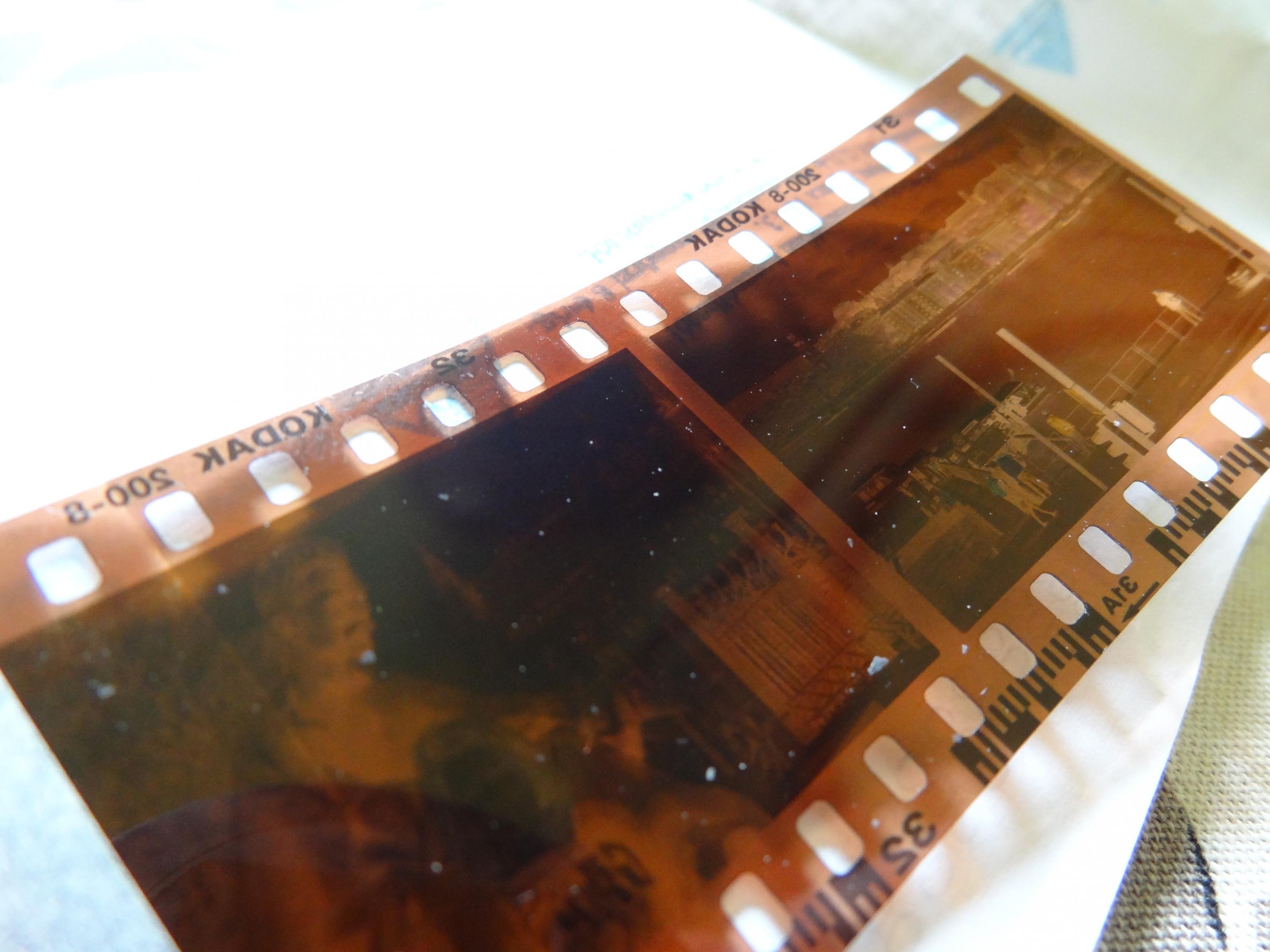

I am using Tetenal C41 and destilled water and I have never come across with this problem.
sagai
Oct 29, 2014
309
Hungary
Actually I retract my previous mentioning.
Now I have the 5 Liter kit rather than the 1 Liter one and ... there are these blxxdy chrystals on the blxxdy emulsion!!!
I am having distilled water, so this is something that develops over the time in the stabilizer and filtering could get rid off, or I should forget completely this stabilizer?
One question, I know it difficult to decide based on a scanned image ... Are these crystal kind of things or may be something else?

Are you sure that these are particles from STAB, or could this be dust which settled when you dried the film?
Here are some things you could try:
  • Would the particles come off when you blow air at them?
  • Do they come off if you brush them?
  • Can you wash them off with distilled water?
  • Can you remove them with water that contains a sequestering agent for water hardness?
Once we have answers to the above questions, we can speculate about the nature of these particles and think up a suitable remedy.
PS: Even if you mix your STAB with distilled water, you have tap water carryover from the preceding wash step as you reuse the bath. In my experience you have about 10-20ml carryover per run (assuming Jobo 1510 or 1520 tank, Patersons of same size will be similar), imagine what this means if you reuse a bath ten times.

These are sticking in the emulsion.
I am thinking of that there are the answers in your ps. ... May be the water before stabilizer I do not know ...
So is it technically possible that the dusty water before stab remains dust on the negative and then the stab fixes those on the emulsion?
That is the thing here only on emulsion side:

That looks like junk from the air or water (solutions). It then dries on the film and leaves permanent marks.
Try filtering your solutions. Use a filter for your wash water.

I would still try that last experiment with water hardness sequestering agent. You don't have to get special chemicals, suitable products are sold as auxiliary cleaning agents for dish washers and laundry machines.

Sorry Rudeofus, what do you mean?
Calgonit kind of thing?
Rudeofus
Aug 13, 2009
5,081
EU
Yes, there should be several products which do just that, but Calgonit is probably the most well known and advertised brand.
