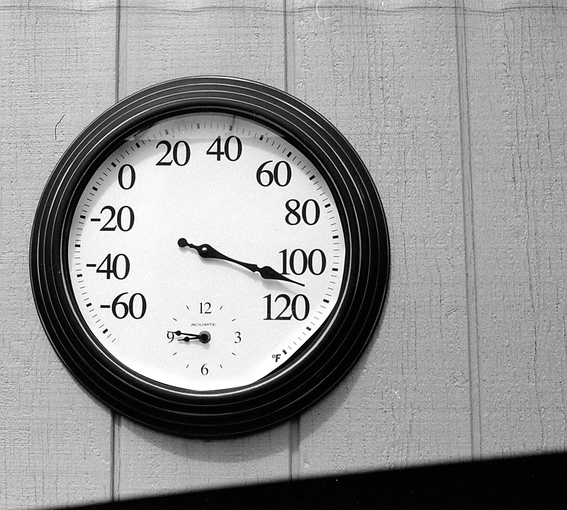

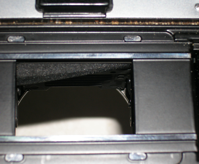

Actually, I'm not sure of the terminology so I have attached a couple of pics of the problem. What looks like shutter curtain fabric is hanging down into the frame area. Since the shutter moves horizontally, and this is hanging from above, I am puzzled as to what it is. It looks as if it was clamped/pinched between a fabric covered bar, located at the top of the negative area. I hope my description makes some sense. It is a very nice body, but probably not worth a trip to a tech. Any thoughts on this problem?
Thanks,
Gerry
I also included an image showing the effects of the problem. Of course, no problem was apparent in the VF. All images from the roll show the same results.

It's part of a light trap. LOck the camera on B. and gently pull it out.
When you look at the mirror(bottom you can see two small "fingers" coming from the sides. The fabric slides under those "fingers".
That's all there is to it. Use tweezers, it's easier.
