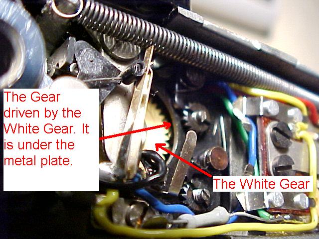

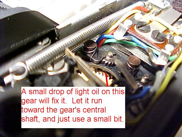

Haven't had that problem but the SRT series is widely known for one gear in the train to run dry and cause everything shutter-wise to get wonky. You will know you have this problem when the second curtain stops halfway across its path at shutter speeds of 1/30 or slower. This will also prevent the mirror kick-out from working so your mirror will hang. Then things get worse. 20 or so years ago I finally made the attached two annotated files explaining how to easily solve it. Remove the bottom plate to find the gear...
View attachment 225753 View attachment 225754
Thank you for this information. However, it must be said that the SRT series gives new impetus to the realization that this model is nearly as solidly built as the RF Leica. That, and the Spotmatic. - David Lyga
