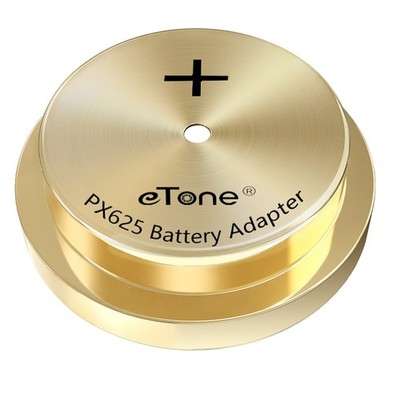

I’m having a difficult time recalling the name of the battery adapter for converting SR44 batteries to the correct voltage for, example, a Canon F1n or FTb, etc.
What’s the correct name please and who sells it?
I think it was called the MR-9? There's a seller on Ebay from Japan
KANTO camera Genuine MR-9 mercury battery adapter SR43 Conversion 1.35v JAPAN​

👍 Be careful when reading the product description in the eBay ad, when selecting a suitable product:
  1. the RIGHT product mentions Voltage Conversion, to prodvide the needed 1.35V, such as the description '1.55V to MR-9 1.35V'
  2. the WRONG product assumes you have inserted an Air Cell, and merely adapts the SIZE of the smaller cell to fit within the larger diameter space originally designed for the mercury oxide battery...usually a small air hole is drilled in the outside to permit air to get to the air cell!
"Voltage Compatibility: This adapter does not alter voltage levels, ensuring safe and reliable performance.​
Battery Compatibility: Works seamlessly with Hearing Aid Batteries Size 675 PR44, a 1.4V Zinc air battery, or LR44 (1.5V, requiring manual exposure adjustments)."​
...and BOTH are called 'MR-9" in eBay ads!!!
Spending a bit more, for the Criscam product ensures the proper funcitonality (not using air cell to get 1.35V)

At that price this is guaranteed to be an adapter, but not a voltage converter.
Meaning it will only work with the relatively short life zinc air hearing aid batteries.
Also meaning that using "MR-9" in the description is misleading, because the MR-9 actually provided voltage conversion.
I've actually used these sort of adapters before, and in the right application, they make sense.
Just not in cameras that you want to offer long battery life.
For those, I prefer something like the MR-9 adapters.
