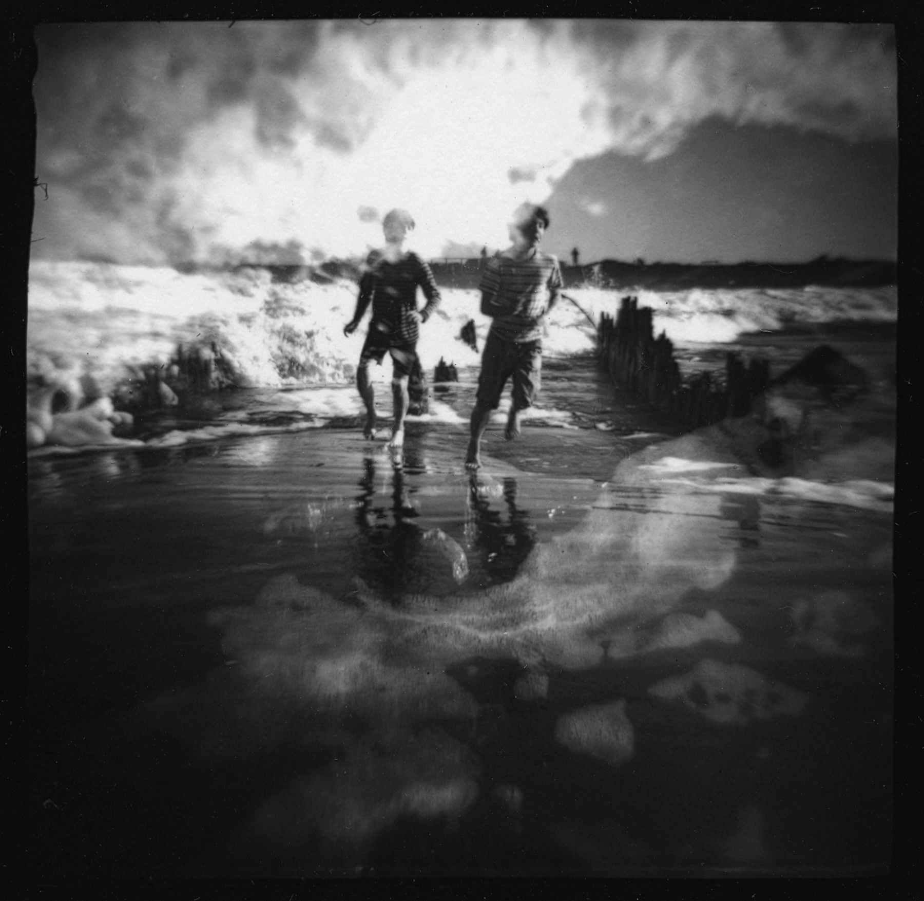

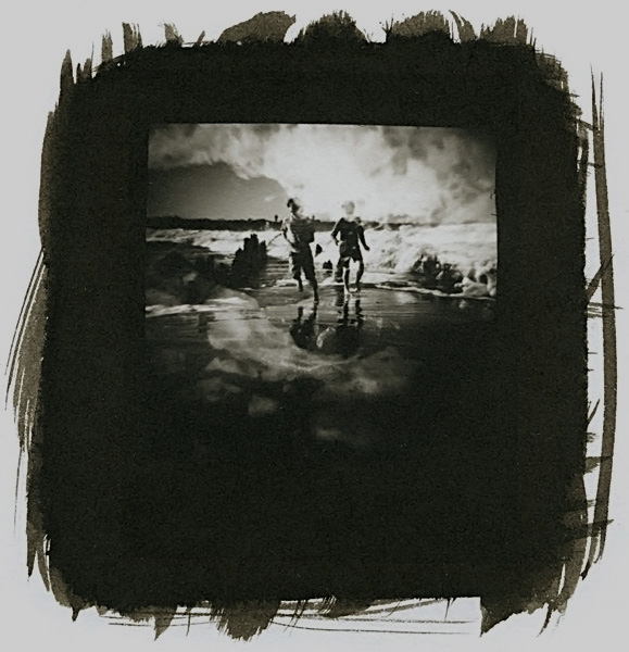

And since I print both in platinum and in carbon (which reverses the image -- mirror image), I find some images work either way, and some do not. But usually I compose an image to work primarily in one of the two processes and not both.
Attached are carbon and platinum prints of the same negative (Tech Pan in a Diana camera).
