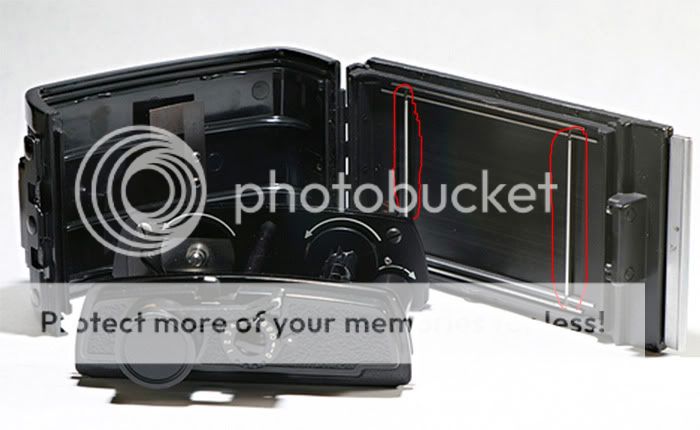

The problem comes in from some older graflex backs not having rollers that hold the film flat. The knob wind backs tend to lack them, though I've seen several exceptions to that rule. AFAIK, all lever wind backs have the rollers. Here's a picture of a graflex back with the rollers I'm talking about circled:
If you're buying a knob wind back online, ask for pictures of the inside so you can see if the rollers are there or not.
