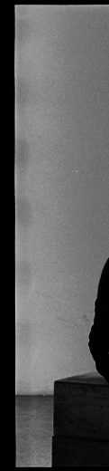

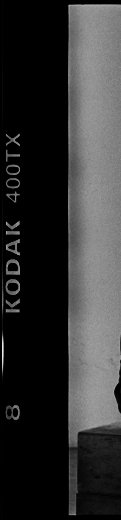

I'll post an example or two here from the contact sheet, I've ganked the contrast to make it obvious it. The negatives aren't nearly that wild...but you can still see there's some stuff going on. These are by far the worst examples.
Oh, and finally, it's most prominent for the first 12 shots...so the center of the reel.
Actually, now that I look at the sample #2 there, it does look like bromide drag doesn't it. Darn...why would it be popping up now?

Oh, and I should add, on those samples, to disregard the general increase of density gradient bleeding in. That's not on the film, but from doing a sloppy flatbed scan, film curl.
No, it's those sprocket hole marks I'm trying to figure out...

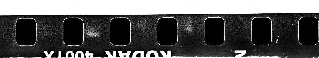

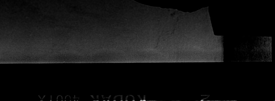

Okay, these scans probably aren't going to help much. But I did a light one around the sprocket holes w/ increased contrast, and a dark one into the film edge w/ increased contrast. In the dark one the decrease in density does roughly correspond with the sprocket holes. Which suggests bromide drag. But around the sprocket holes it is certainly not even...which is odd too. But then again, I don't often examine my sprocket holes like this...maybe they're always like that. But I don't think so.
Then there's that weird squiggly line of increased density outlining the problem area in the fra,e. Would that be a product of bromide drag too?
Huh. Anyway. This, + the scratch makes it about the ugliest roll of film I've ran in sometime. Luckily the rest were okay. But I do thank you all for helping me look into it.
