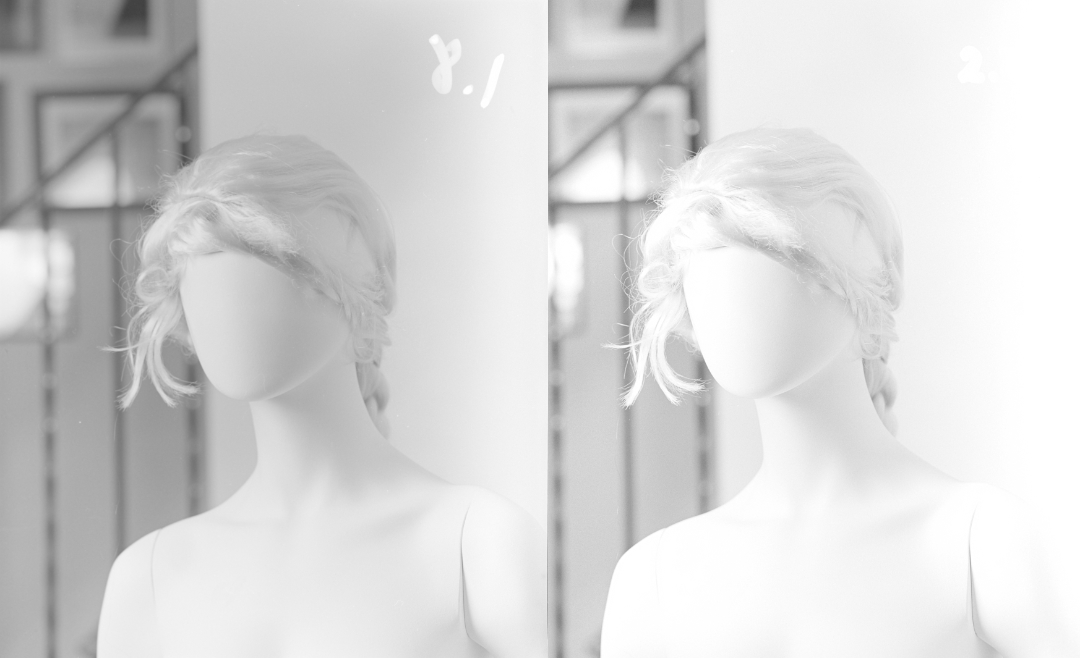

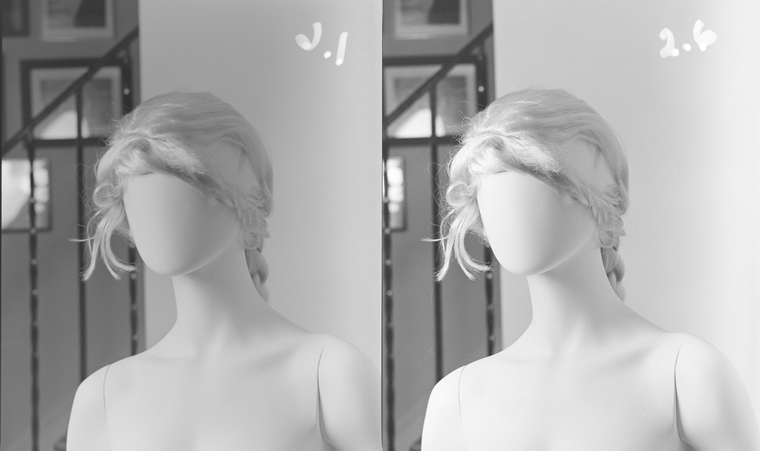

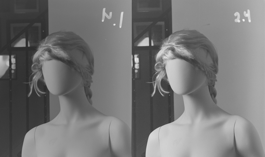

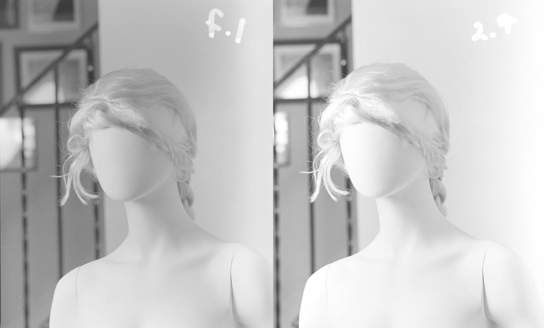

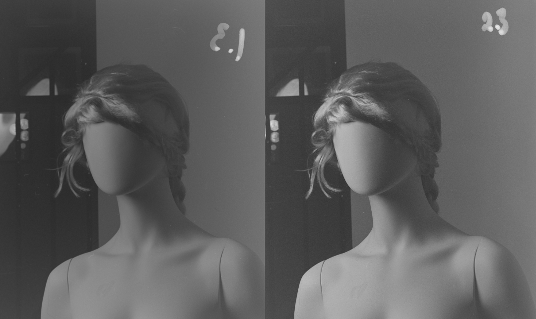

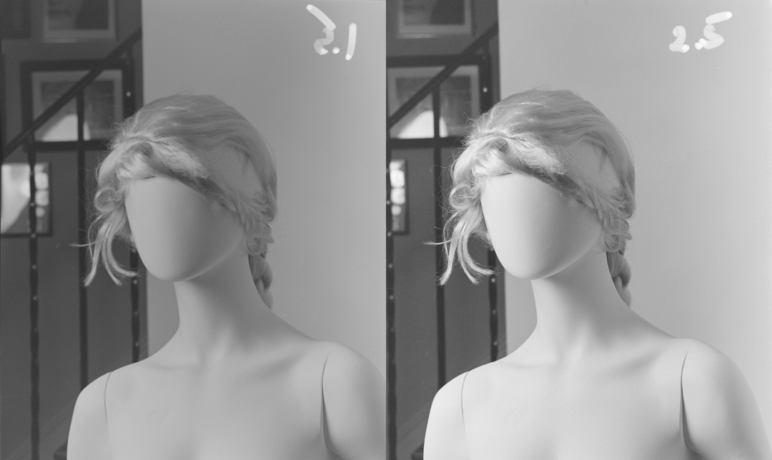

I'm excited to present you, based on absolutely no popular demand whatsoever, this side-by-side comparison of Sprint Standard and Kodak HC-110 (new formula)!
"But, Why? Who cares?" - Well, perhaps just me, because I started my still-young darkroom career using HC-110 and Ilford fixer & wash, but after a few months slowly slid into purchasing exclusively Sprint products during the pandemic because, frankly, they had everything available in one convenient location during a time when there always seemed to be *something* out of stock at B&H, Adorama, and Freestyle. So, to stop the madness of a different brand each for developer, fixer, wash for film and print, I started purchasing everything from Sprint.
Now that life has begun anew (er, rather, now that we are recklessly willing ourselves towards that end) I figured I would finally take the time to do a comparison of the two. And, my oh my, have I learned a thing or two. In no particular order:
1. I now think I understand acutance. Goodness, what a difference. Standard has none in comparison to HC-110.
2. However, Standard does an amazing job maintaining highlights.
3. Additionally, Standard also "controls" (or perhaps inhibits is a better word?) grain.
4. Having said #1, #2, and #3, the images developed with Standard certainly lack pop. You will decide whether that's good or bad.
Methodology:
* large beauty dish metered to f16.
* Sheila, my model, agreed to stand perfectly still during the entire shoot.
* Mamiya RB67 with Sekor 180mm.
* From left to right, f5.6, f8, f11, f16, f22, f32
* Image on left is Sprint Standard. Image on right is HC-110
* Ignore the numbering - it made sense to me at the time but ended up being largely pointless. Yes, I know, they are backwards on the Sprint frames, because I wrote them on the non-emulsion side, then wrote on emulsion side for Kodak.
* Images scanned with my Canon EOS R6, emulsion-side up.
* Exact same settings (only two) applied to each image in C1, to wit, 1. invert, then 2. stretch out the histogram a bit.
f5_6_small.jpg F8_small.jpg f11_small.jpg f16_small.jpg f22_small.jpg f32_small.jpg

It looks to me like the HC-110 negatives were developed to significantly higher contrast than the Sprint negatives, which can make it difficult to compare them because the degree of development and contrast affect both objective and subjective (perceptual) sharpness, grain, pop etc.
Just something to keep in mind when comparing films and developers.
OK, learning moment for me. How would you control for that? They were both developed to Massive Dev recommended times per temperature.
correction - Standard developed per Sprint recommendation per temp / HC-110 per Massive Dev. Perhaps that was the problem.
Yep, that is the problem.
Tell us what the developing times were.
It may be that you over-developed with HC-110. It may be that with your conditions, you under-developed with the Sprint developer. Or it may be that you did both.

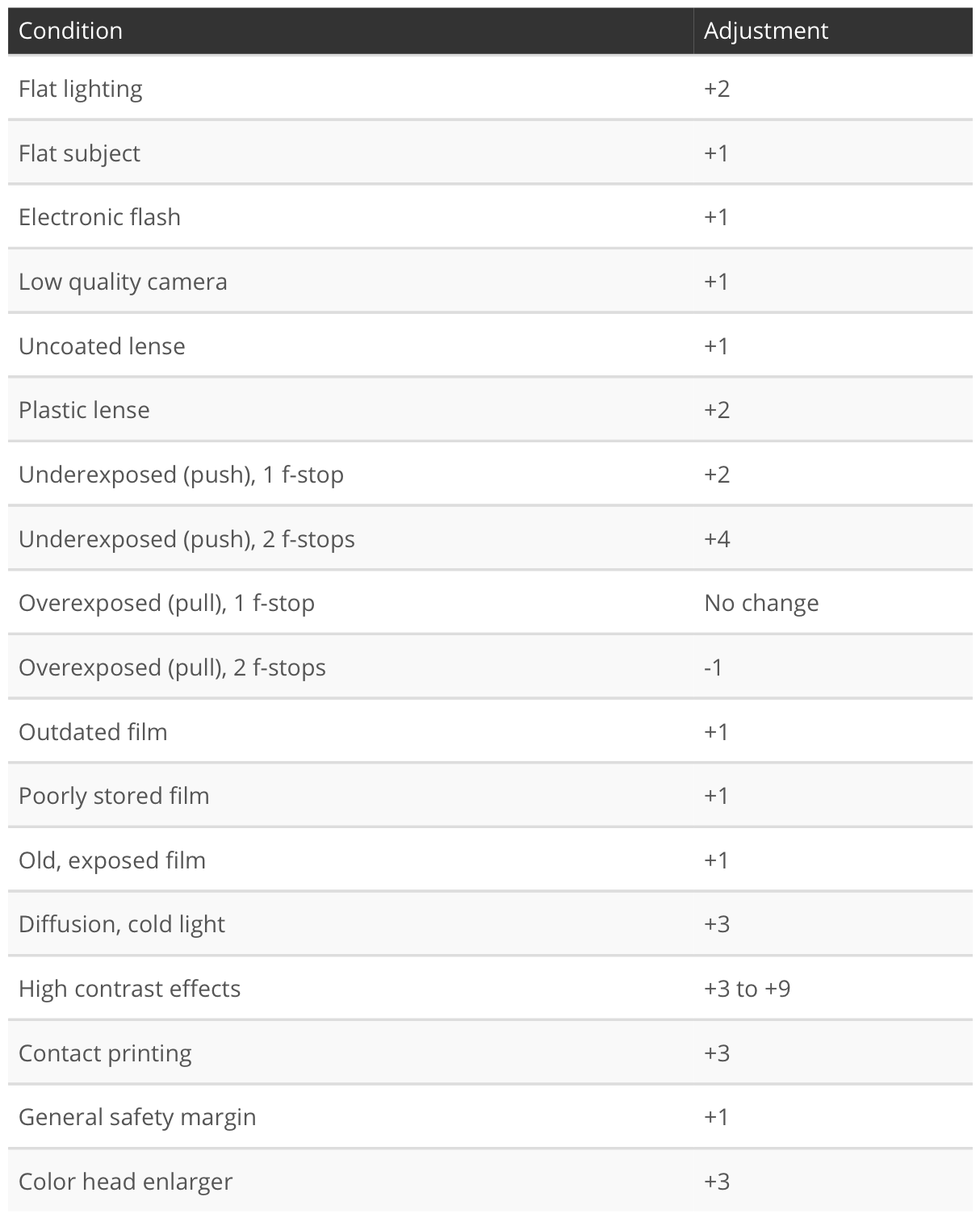

Besides the temp adjustment table, you can also look at the "Letter Adjustments" table they provide:
