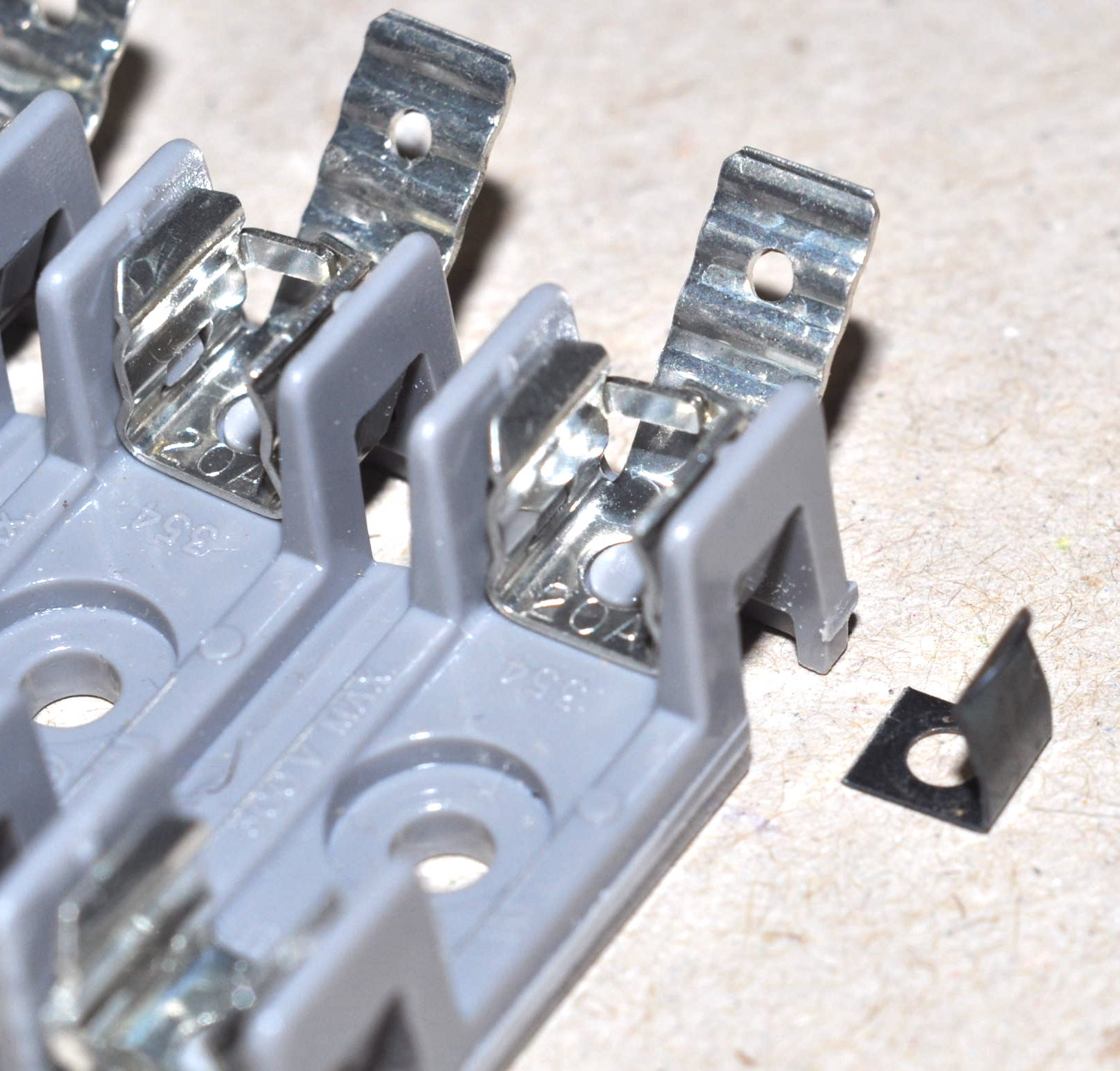

To make the spring I'll use a feeler gauge. I'll heat it red hot so I can bend it. Then I'll polish it and then heat it only enough to turn blue. That will turn it into a spring.

After polishing with a wire brush (does not show well with flash). Polishing removes the black residue from the previous heating so the color change of the next step is evident.

Heating just until it turns blue. Now it is a spring.
BTW, when I make parts like this I err on the side of 'just a little too big' as the parts can be filed smaller if needed. In this case it fit just fine, so I left it this size.

Works gerat! The spring grabs a pin on the side of the camera. Now my handle stays in place!!
