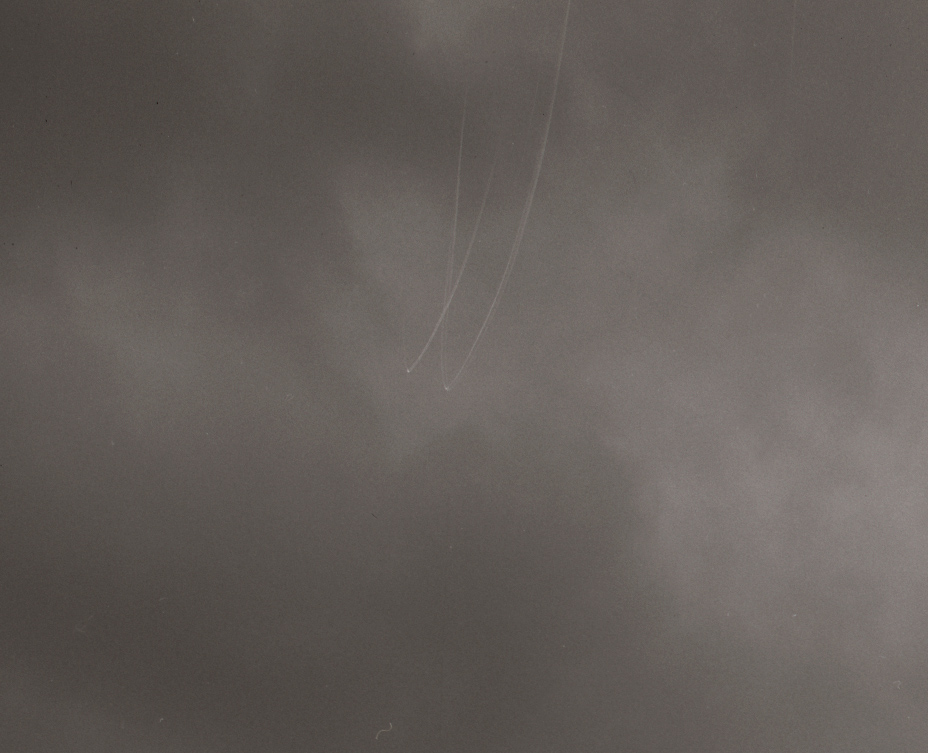

Here is the culprit of which I spoke. I scanned the neg and cropped to show you just the scratch in the cloud area. This is a scan of a negative, in positive format.
I am really new to spotting. What would you do with this? Should I try to fix the neg?

You use six bottles when you are using this stuff a lot. You get to know the density increase with each and sometimes a 9 x 9 negative might have 25% or more of it's surface adjusted. There might be 2 or 3 dilutions used on a negative as well as multiple applications for in between values. Apply with Qtip or cotton pad.

It is easier to darken a print with Spot tone or similar than lighten a dark line which will be more obvious as you need to add white. I would fill the scratch and spot the print. If a client sent me a scratched negative the treatment depended on the quantity to be printed. For quantity printing we would clean up a good print and make a copy negative for reproduction.

I have been playing with this a little in the darkroom. I tried Edwal No Scratch, to no avail. As I was doing this, I thought of a question that may seem stupid, but here goes.
The negative is scratched. That should mean that more light gets through to the paper, right? Yet on the print, the scratch is LIGHTER than the rest, not darker. Or am I not getting something?
greybeard
Jun 10, 2005
366
Northern Cal
Don,
Light scratches look white on the print because they scatter light away from themselves; the light which should have exposed the area under the scratch gets distributed elsewhere and just contributes to very faint overall glare. A deep scratch, on the other hand, will print dark if it goes most or all of the way through the emulsion. Try lightly scratching a piece of blank film before putting it in the enlarger and you should see this quite clearly. The more collimated the light source, the stronger the effect (i.e.--condenser versus diffusion enlarger).
Interestingly, the phenomenon leads to one way of fixing airbells (the small, round undeveloped spots caused by air bubbles): a needle is used to make tiny dimples or scratches, so that the light coming through the clear spot is scattered away and causing the spot to print light gray or even white.
