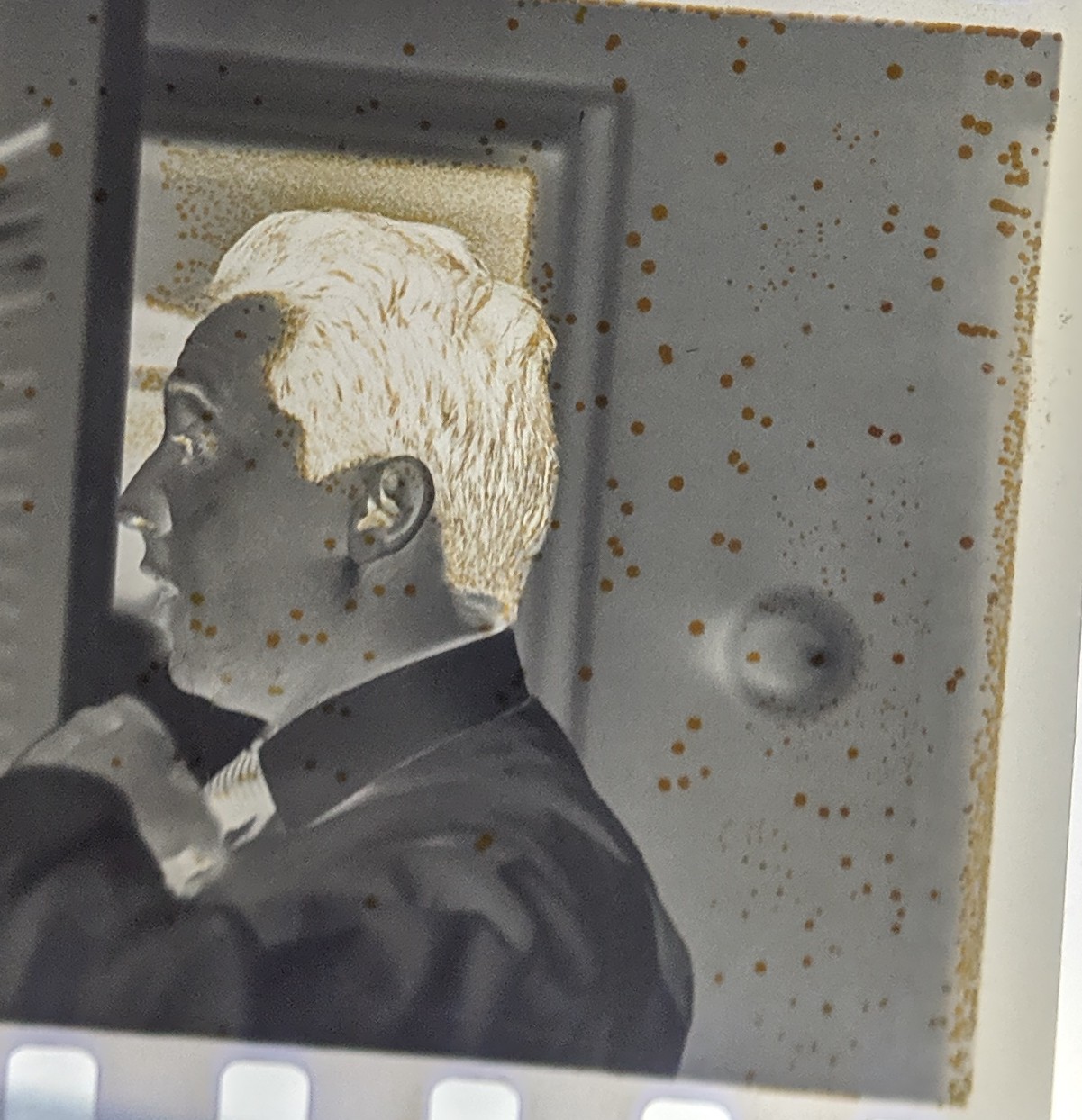

Im looking through some old contact sheets. 9 years ago maybe, and noticed all the negatives on the right hand side of ma print file sleeve has these spots. Only this one sleeve. Redish spots. Any ideas? Im guessing something after processing, since its only on frames 6, 12, etc...
Thanks for any info..

Hm.. I cannot feel any texture, not sure which side of the film its on. Looks the same on both.

I thought that too, although I've never seen what it looks like, and if its similar, but, its on the right most negative of each strip on a print file sheet. Thought it would be weird for the fungus to spread down across the individual slots as opposed to across the film to the frames to the left of it.

It may have migrated from the container used to store the print file sheets.
Were they in a binder, and might it be rust?

They are in one of them plastic archival locking binders , with another 100 or so sheets, this is the only sheet I can find that has this. Rust? hm. the rings on the binder are not rusting.
I will try the alcohol idea see how it goes. maybe some Pec-12, or something to that affect?

Looks like insufficient fixing. Remaining silver halide will bind with atmospheric sulfer and possibly other species to form more visible silver sulfide. If this hypothesis is correct, you're out of luck; the spots will be more resistant to any kind of treatment than the silver image itself.

Im still not 100% sure about what it might be, because its only on the ends of the cut film, frames 6/12/18/24/30/36. I find it weird that I didn't wash the film correctly and that fixer stayed behind only on those frames? Not saying I have a perfect process, far from.Film is hanging, precut after washing until completely dry. I would think that the spots would be more spread than just these specific frames.
Either way, ill try and wash it some way, but im pretty sure these frames are lost. Nothing important really. Just wanted to get to the bottom of it to see if it was something I was doing wrong. Since this is the only sheet with this issue im going to not worry too much about my process...

The spots are only on the frames you mentioned because they are more in contact with air, being the outside frames of the cut strips, close to the edge of the sleeve. Don't worry though, the other frames will also develop these spots in due course.
You may want to try refixing these negatives if you want to keep them. It won't repair the lost images, but it will put a stop to degradation of the others.

It could also be caused by spots of chemicals landing on the film and reacting with the silver in storage. Perhaps some airborne chemical powder landed on the film or liquid splashed it after processing. Maybe some air bubbles formed on the film during fixing. You could sepia-tone the negs (re-fix and wash well first), or scan and/or print them if you want to save them for later use.
