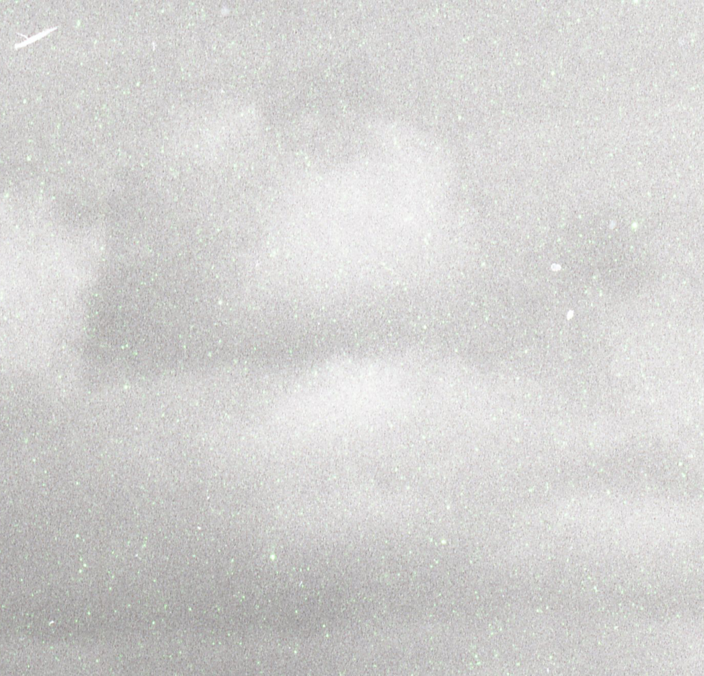

I have attached a couple of scans of the worst culprits (foma on the left and FP4 on the right).
If anyone has any ideas as to the reason for the spots, I would be very grateful as I would like a solution before I use and process more of the 120 FP4 and Fomapan 100. Looking at what I have read, it could be something to do with freezing the film and/or the fixer but my results show that it could be either or both or none of these! I don't mind throwing out the fixer but would prefer not to thow out all the film!!

The SPOTS(1) problem is backing paper offset, at least in the form shown in your FP4 (I assume FP4+) example.
The magenta SPOTS(2) on Fomapan AFAIK should wash out normally if a reasonably fresh fixer is used; I suppose you could just give an extended wash, perhaps with some sodium sulfite, too. If you do a search on this forum, you'll see this problem being discussed (although much less so than the backing paper issue). I've not personally seen these particular spots on my own film, so please refer to the advice others give concerning this specific issue.
The reason why you're not seeing this on your 35mm film is because SPOTS(1) is related to backing paper, which 35mm of course doesn't have. I think the SPOTS(2) issue is related to the anti-halation backing on the Fomapan roll films which is also lacking in their 35mm product.
The reason why you're not seeing this on the 120 HP5+ is sheer luck - or rather bad luck on account of the FP4+ and Fomapan. Backing paper offset problems are somewhat rare, but they do also occur occasionally with HP5+.

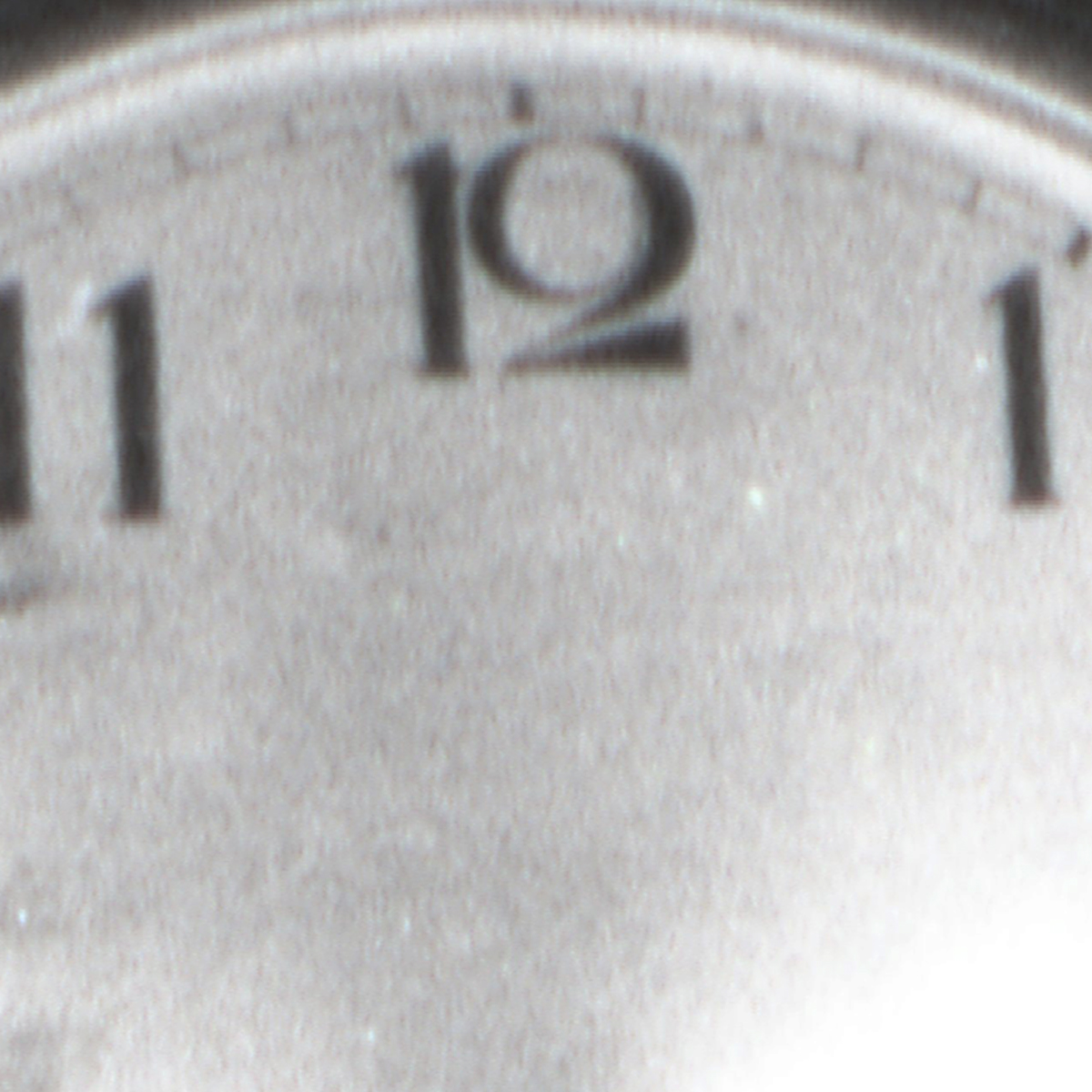

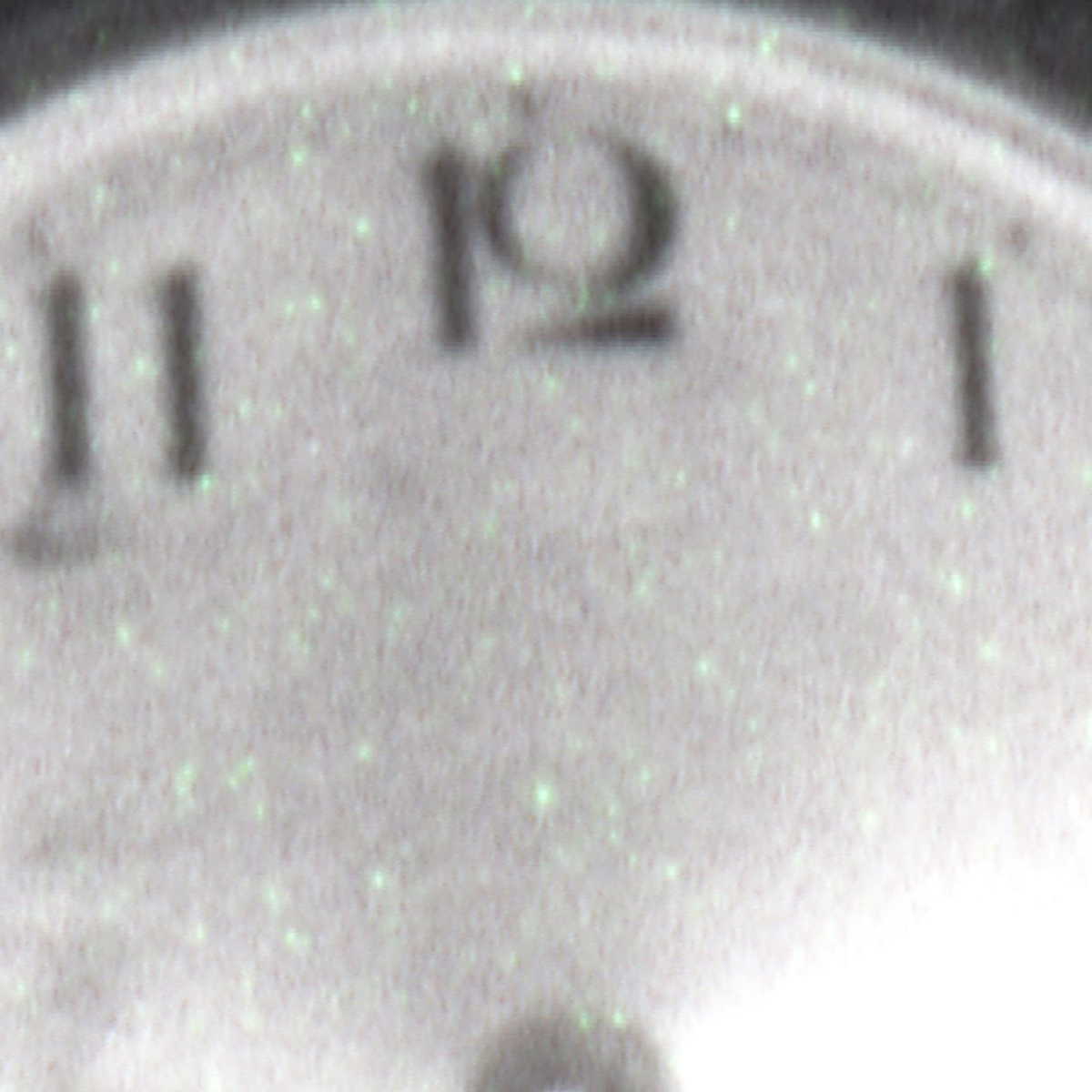

Thanks for the advice. I cut a strip of 4 negatives in half and followed the instructions in the link above. Treated one strip in isopropyl alcohol: water mixed 1:1 at about 20oC for 45mins agitating very gently once every 5 mins. Washed for 40 mins. The results are shown below (scanned in colour at 12800 dpi) . (The untreated one is out of focus but that was my fault when I took the photo - nothing to do with the treatment.) The spots have pretty much all gone with no effect on the image on the negative. The alcohol:water mixture had quite a purple colour at the end.
I have two other Fomapan 100 films bought at the same time as this one (both expire in 06/2027 not refrigerated) so I can assume these films will have the same problem. So my final question is this.
No damage was done to the film by treating it after processing but, would I damage the emulsion if I pre-soaked the films in alcohol: water mixed 1:1 to make sure all the AHL was removed before developing the film?
Thanks again
