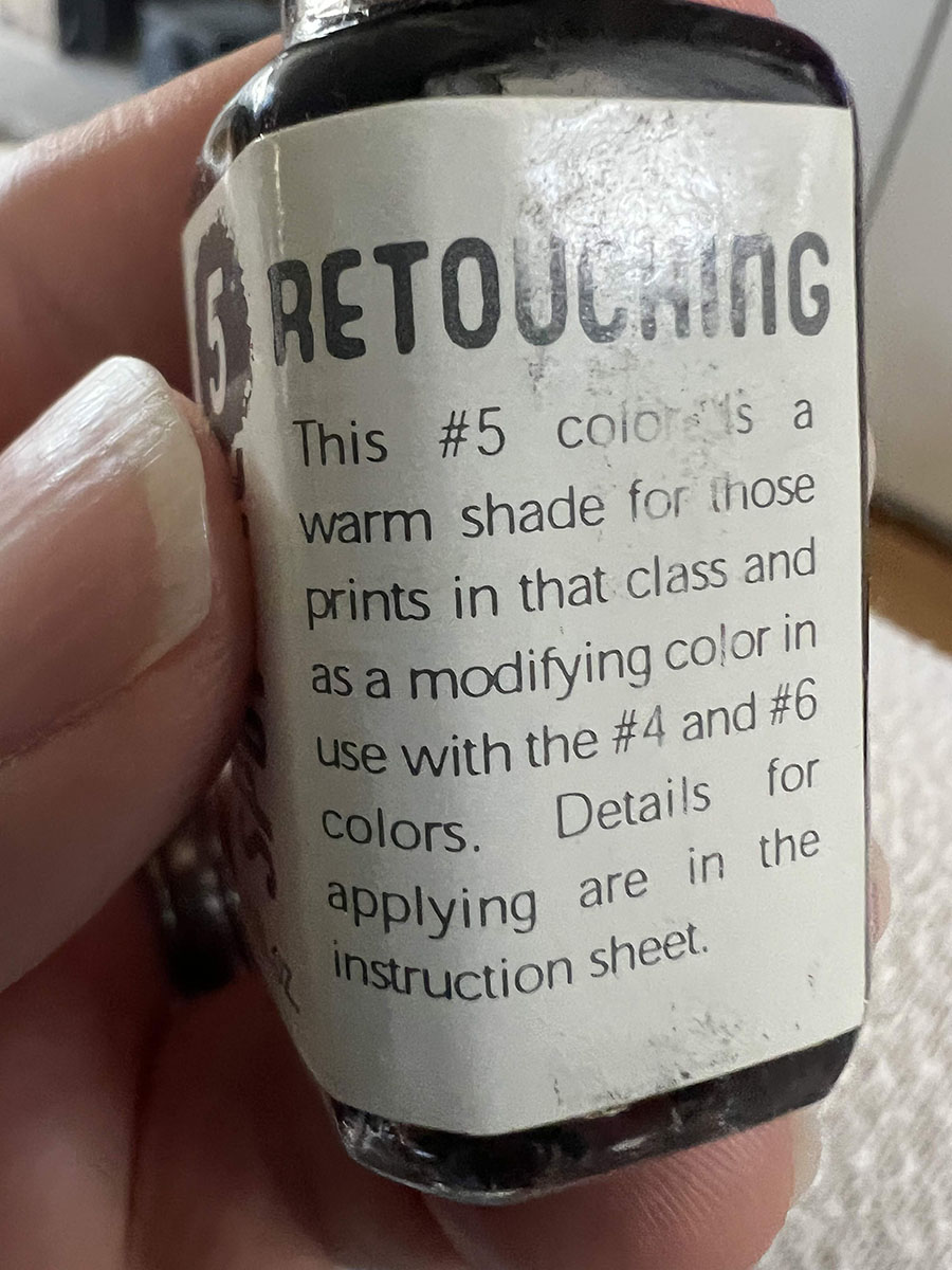

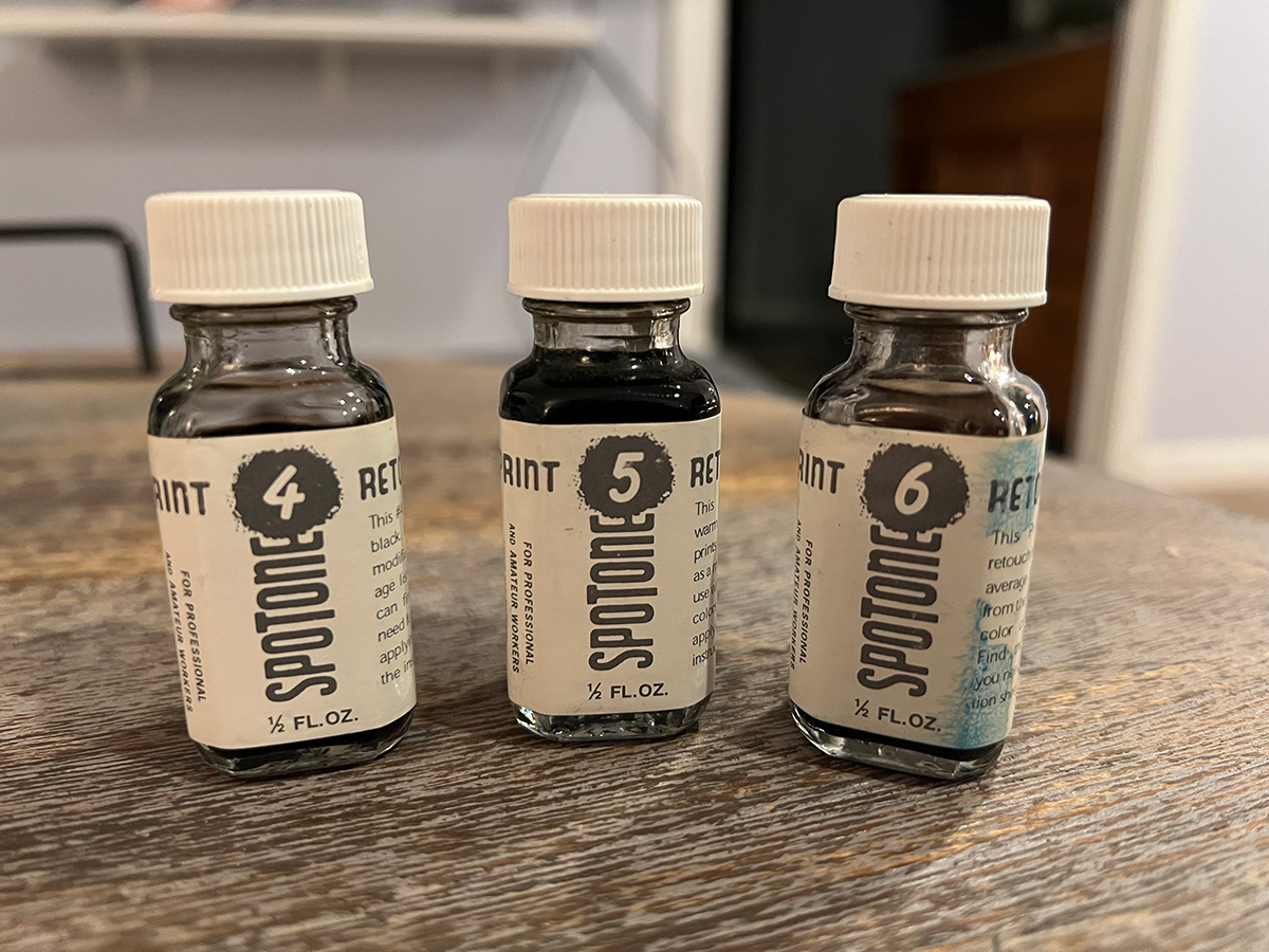

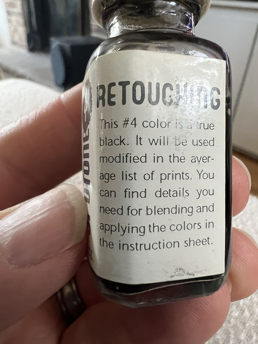

Ok, now I feel really dumb. After reading Vaughn's suggestion of actually reading the labels!! All the info is there. I'm blaming the fact that without very strong reading glasses those lables just look like a blur!! Here are the pics for future reference.

Thank you very much for the new images!
It has been awhile since I have spotted Portriga Rapid, but I mentioned I used S (for sepia?) Spotone. I found my bottle of #2 Spotone that I might have added to the #3. It was the #1-#2-#3 Spotone sets that I remember from the 70s/80s. I had a bottle of O Spotone (olive-greenish, I believe), but did not need it.
Nice to have around. While I do not print with silver gelatin papers these days, I have too many old unspotted selenium-toned 16x20 prints...who knows might be worth spotting one or two someday. And very carefully I use it on platinum prints on very small minor spots.

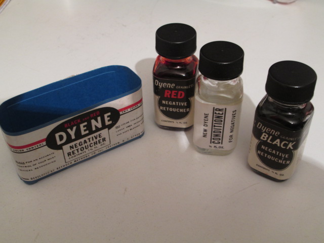

Having trouble with posting the resized scans.
There is the lower half to come yet plus DYENE instructions.

Sorry about the images. I had to re-size everything to less than 2MB.
The Spotone sheet is larger than my document scanner so it had to be done in two separate scans.
I got there in the end though.

Thanks Bob UK.... in all the years of using Spotone I had never seen those instructions.

Retouching negatives is a very different subject. Red Creosin dye has long been used to hold back portions of negative. I have a little bottle of the Kodak powder that will last me the rest of my life. Photographer's Formulary now offers something similar. It can be diluted way down, and then be gradually built up to produce the exact amount of light blockage you need.
