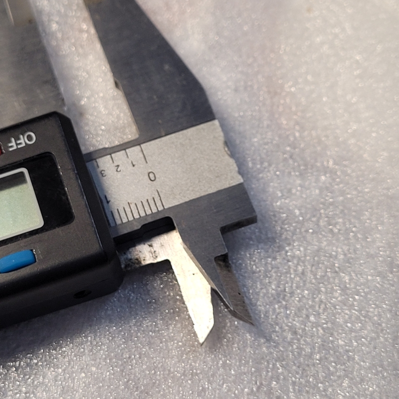

I want to renew the leather of my Spotmatic SPII. Of course it is possible to cut the leather in the area of the self-timer lever, but I want to do it not the quick and dirty way. Which tool should I use to remove the lever? Some recommended a lens wrench, but the two wholes are only 6mm apart. Which one would fit? Or is there any other recommendation to open the screw without scratching the surface? Will it be opened clockwise or counterclockwise? Many thanks in advance.

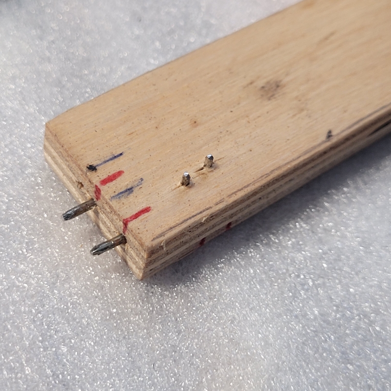

Occasionally I need to remove parts on a camera but have never invested in lens wrenches.
Two ways that I have tried and have had a 95% success rate is with either a caliper or a simple homemade "wrench".
The "wrench" is simply a piece of 1/4 plywood or any similar piece of wood, a fine Sharpie and some brads. I place the wood on the piece to be removed, mark the distance, drill very small starter holes and insert the brads (after removing the head) with a pair of needlenose pliers and file the point of the brad a bit. Carefully inserting into the holes and steady yet gentle pressure twist and break it loose. Then once it's loose it can usually be removed with finger pressure or with a piece of duct tape for some grip.
Forgot to add: most likely it is counterclockwise, everything I have done has worked this way. It should break loose pretty easily so if it doesn't I guess it would be clockwise but I think that is very uncommon.

Agreed. Take your time and steady yet (very) gentle twisting should work just fine.

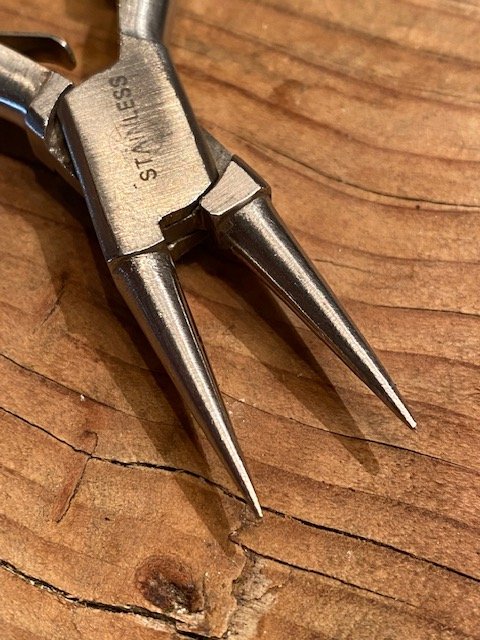

I use a pair of lead-forming pliers. You can find them at most electronics suppliers. Perfect for small camera parts.

I bought a pair of long(er) nose pliers like AZD's at the Dollar Tree (Home of Fine Tools) many years ago. After grinding the tips to more of a point, it's worked on just about everything. You would need a proper tool if it were really stuck, but so far so good.

At the end I used a caliper. And just to add this for people with the same question in future: The screw opens as most other screws, counterclockwise.
