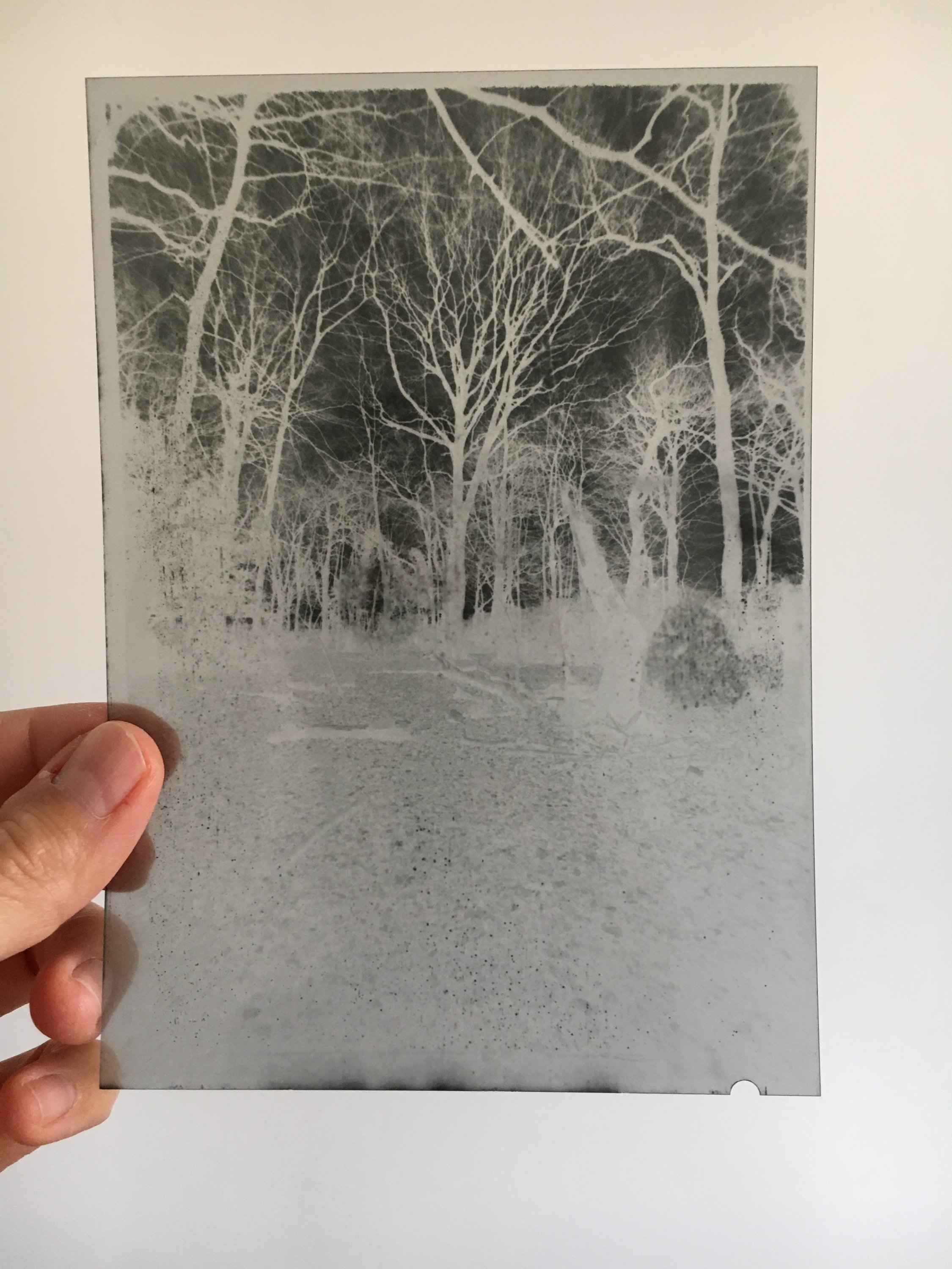

Hi all,

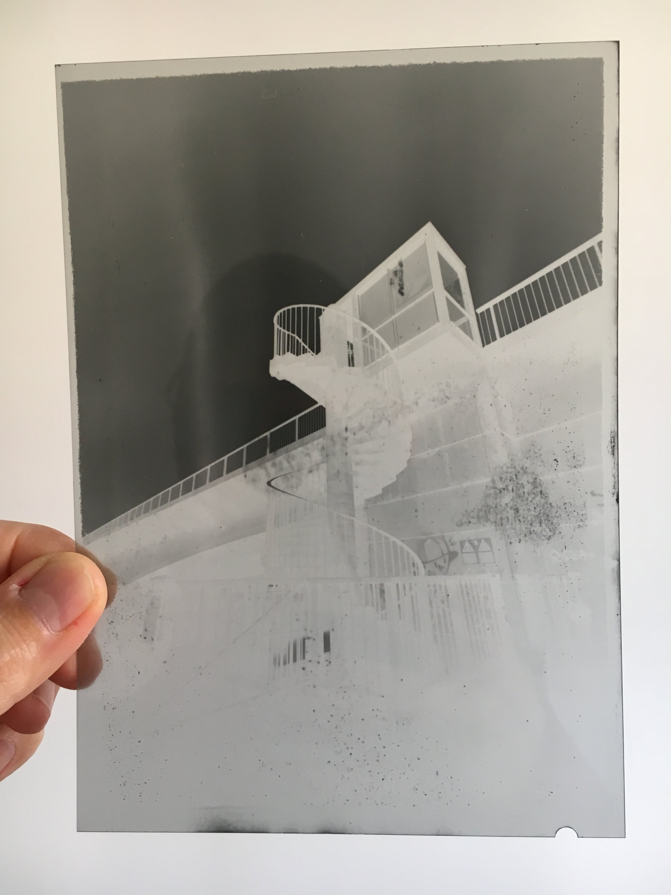

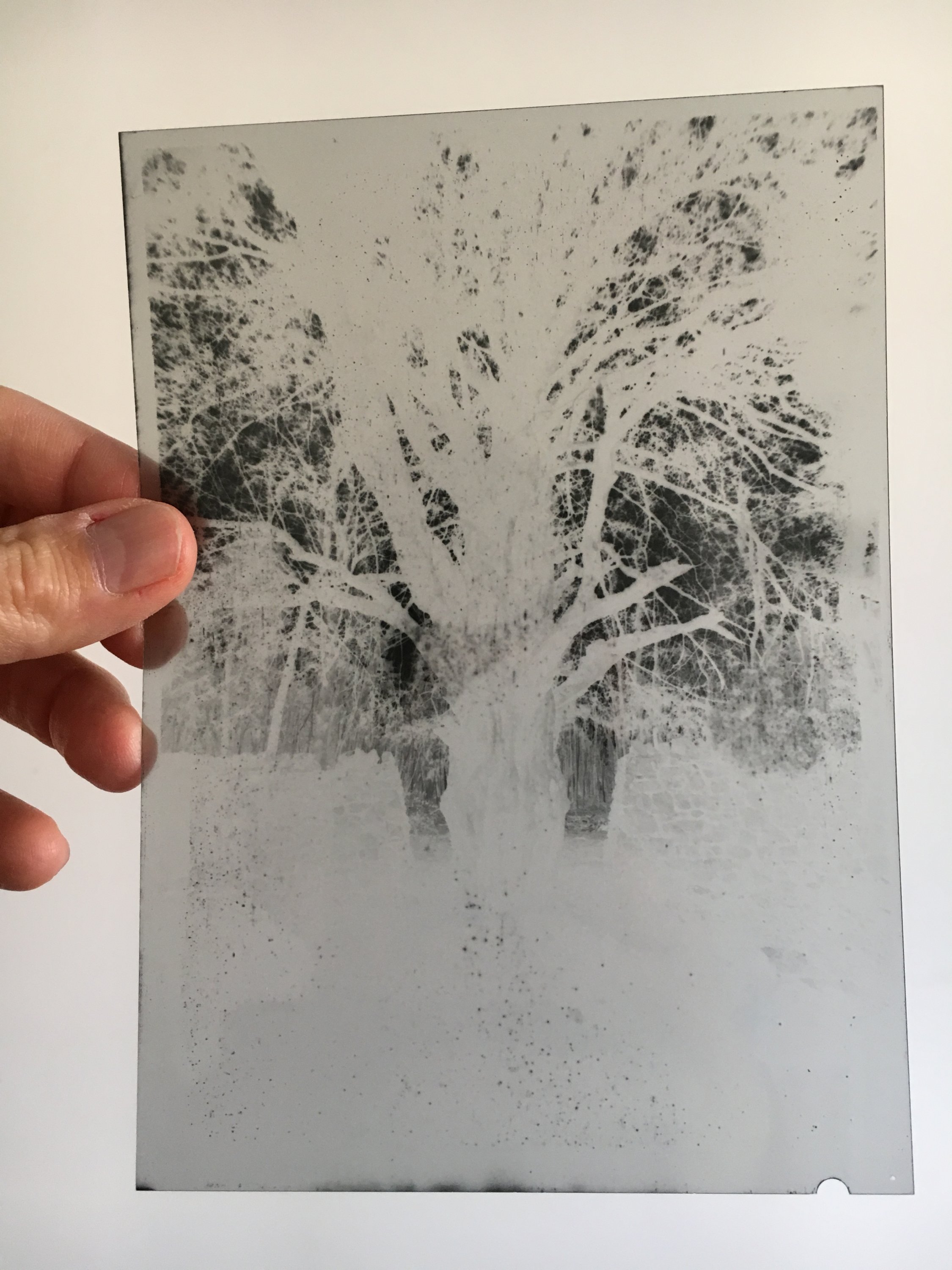

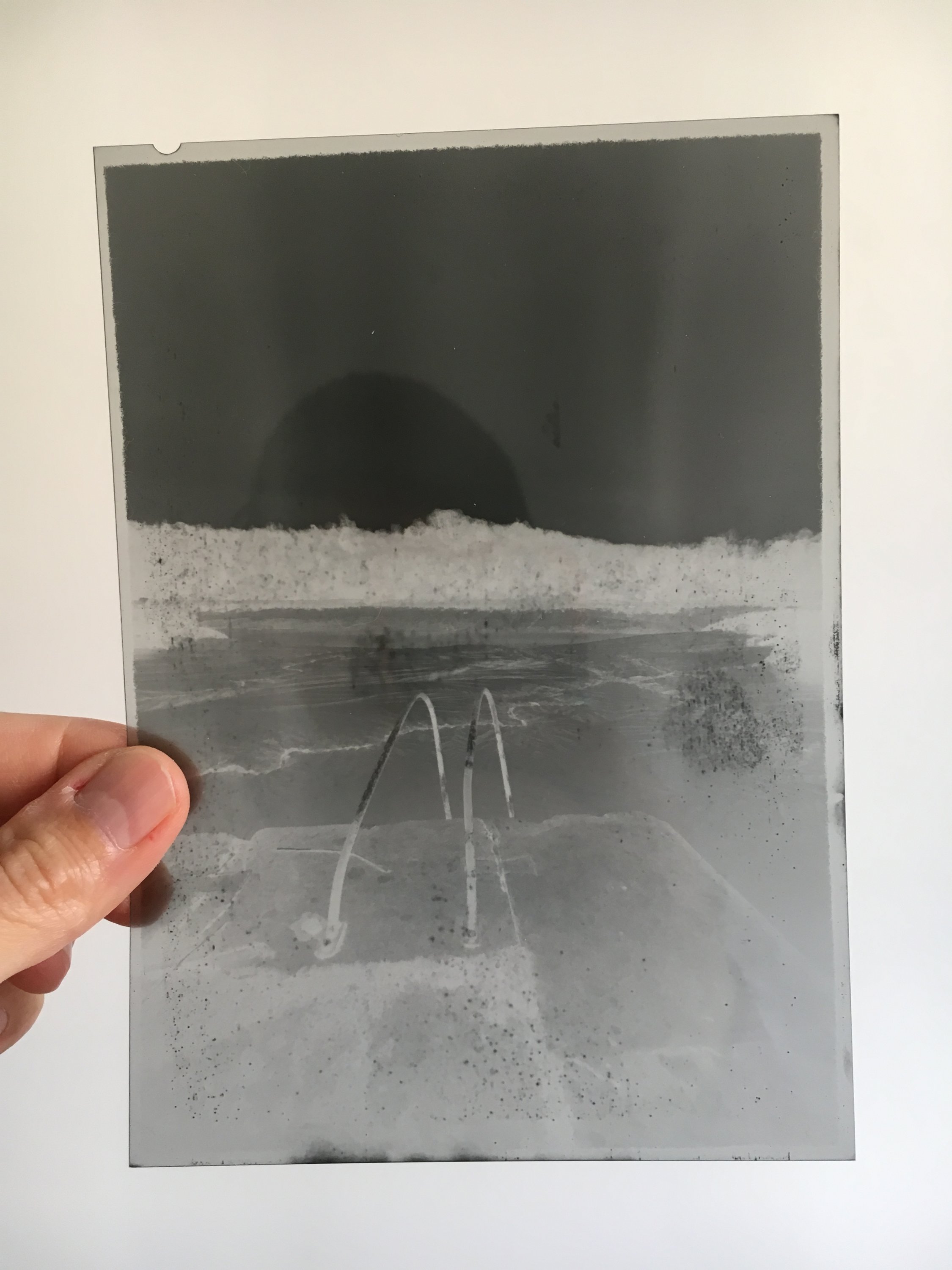

I thought that they were fingerprints when I developed the first and the second. But then I realized that they are the same pattern and they are on all the rest of the negatives. The right side and in the middle and also a lot of black spots everywhere.
As it is a handmade obscura, is it possible that these are lightleaks?
Could it be that the film has some fault? Though I just don’t think that it would produce the same patterns.
Yes, the negs are not the best exposed and developed negs ever but I just started pinhole and to develop in trays so still trying to get the hang of it.
It’s Fomapan 400 in Rodinal 1:50.

Most light leaks don't show up as small spots like that, but a leak is certainly a possibility.
Try processing an unexposed sheet, if there are no spots, then the problem is in the camera. Otherwise, the spots could be a film defect or a darkroom problem.

What is that home made camera made of? If the back is thin wood or cardboard, there could be pores that let light leak in at the same spots in every negative. A layer or two of black paint should remedy it.

Thanks for your response! Since then I was thinking about light leaks but it should be white on the neg not black, right? Because in case of a lightleak too much light would get in so it’d be burned. It’s more like no light affected those areas. I was also thinking about a darkroom problem, but the exact same patterns on all of them?
Will process a blank one and get back to you.
No, a light leak will always be black on a negative - it is a negative! The more light that reaches the film, the darker the negative. Still does not look like a light leak but if you are making your own cameras it could well be.

I agree with grain elevator. You could back a sheet of fresh film with a known opaque sheet such as tinfoil and leave the camera out in sunlight a while for a quick check for this.

I put two layers of black tape on the camera and took two test shots.
All the spots are gone.
Thanks everyone for your input.
