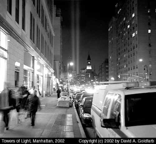

Even without flash, I've found a pretty steady stance with the Technika. I usually use Tri-X at EI 640 in Acufine for available light. Of course a tripod will always produce a sharper image with any camera, but it's not always possible to get the shot that way.
If the light is really low, like in this theatre shot, then subject motion is usually a bigger issue than camera motion, so I might burn a lot of film, and if I get 1 out of 10, that's good. Here, my sister is the sharp one, so the subject motion worked in my favor (Tech V, Tri-X/Acufine, 150/4.5 Xenar at f:4.5, 1/15 sec.)--
