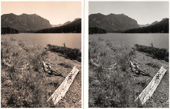

Here is what I got with sepia followed by gp-1 gold toner printed on Agfa MCC III with GAF 135 developer. This is pretty horrible color as you will see and this was done 10 years ago I didn't run further tests on it. The control print is on the right of course.
I am surprised no one else has commented here. Many more of you are split toning, how about sharing?

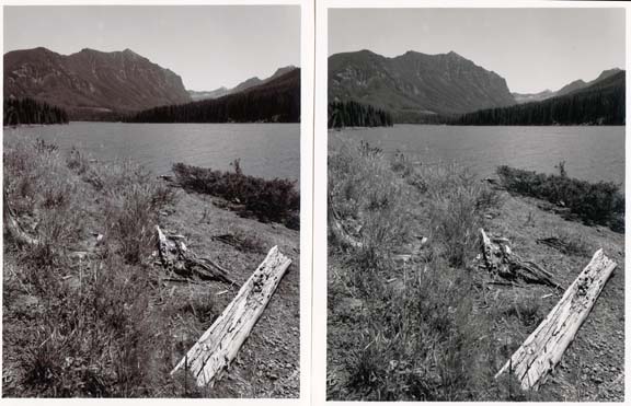

Here is a more pleasing sample of Agfa MC III developed in dektol 1:2 and selenium toned 150cc/litre 10 minutes. The control print again is on the right and is a straight print untoned agfa mc III in dektol 1:2.
This is very hard to show in a scan but the print has split pretty well with heavy selenium toning. I should mention all effects I tested in toning were highly dependent upon the paper developer used. The same toning technique using GAF 135 had a lesser split. Again keep in mind this is hard to see in scans.
Anyone else care to share their split toning techniques?
