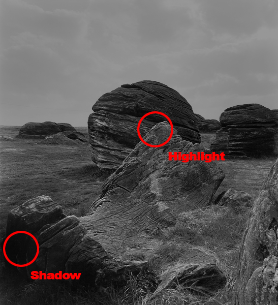

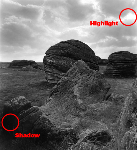

Typically, I will identify the primary highlight and primary shadow detail areas before begining to print a negative (fig1.jpg).

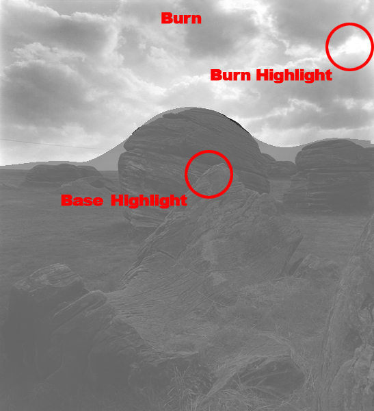

What I ended up doing was subtractive, I shortened the soft exposure to get the highlights I wanted in the rocks and then burned the sky back up to the original soft exposure for the original highlight. This worked but something occured to me...something I plan to try with the next negative I'm printing with similar attributes. What occured to me was that the two, clearly distinct print areas could be dealt with as virtually separate prints.
If I'd identified the primary shadow and the primary highlight in the rocks for the lower "print," (fig2.jpg) then identified that highlight exposure from the soft exposure test strip, I'd have determined a soft exposure for that area directly. I can find the desired base, soft exposure for the primary highlight for each of the two "prints" and extrapolate the burn time from the differential between the two strips (fig3.jpg).
Chancer are good that I wouldn't need a different hard exposure for the area that includes the second, burned highlight. But the same thought process could be applied if necessary.

Lee, they're all the same scan of the same print. In figure two, I masked the sky to indicate that I was just discussing the bottom portion of the print. In fig 3, I showed the burn pattern for the sky. They're all the same.

I think I tried to be too cute with the thread title. I was never talking about the straightforward approach to split-GRADE printing. This was my own personal epiphany that led me to a refinement OF split-grade printing. It has to do with (for certain types of compositions or subjects) treating different areas of the image as though they were separate prints when applying the split-grade methodology. This is where I got splint-PRINT.
I didn't get the right tones for the foreground of the example I posted until I arrived at a soft exposure for the foreground's highlights as opposed to the whole print's highlights.
For me this proved more functional than working from the overall highlight then dodging the heck out of the foreground to rescue the midtones.
