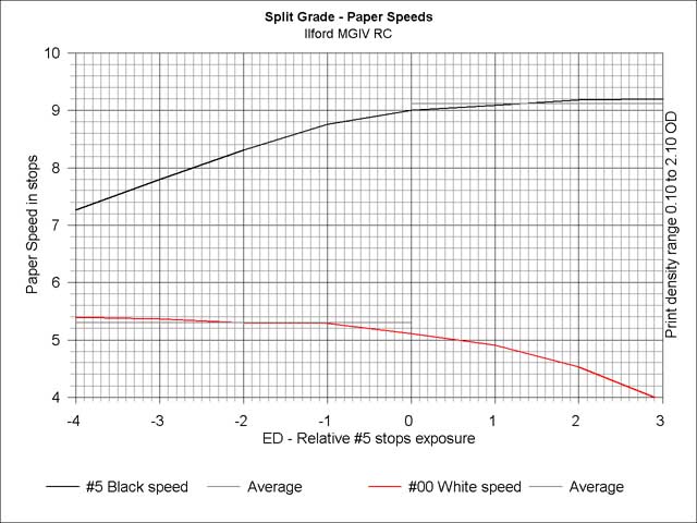

There is a new application note on split-grade printing on the Darkroom Automation web site.
http://www.darkroomautomation.com/support/appnotesgmeasured.pdf
The article stresses that the key point in getting split grade printing to work is the necessity of treating high contrast prints differently from low contrast prints.
In this context high contrast prints are those made with a longer #5 exposure, and low contrast prints are those made with a longer #00 exposure.
When split grade printing in the traditional 2-test strip method:
  • High contrast prints must be made with the black-point/high contrast test strip made first.
  • Low contrast prints must be made with the white-point/low contrast test strip made first.
The article gives detailed information on split grade printing with a meter. It presents a simplified approach in which a simple graph gives you all the information you need to find the correct filter ratio. The complete contrast response of a VC paper - over all filtration settings - can be found with just three prints of a step wedge.

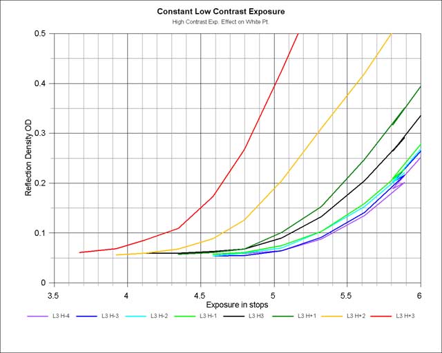

I was looking at your graphs and my own split grade graphs and realized that using this graph, you can make a SINGLE test print. Assuming you have the Darkroom Automation meter and stop timer.
Use the meter to get the density range of the projected image. Use this number to find the corresponding radial line on the graph. The radial lines are lines of equal contrast. Then guess at a time with which to set the 'stop timer' for the first test exposure sequence (either color first) and read the corresponding start time for the second color exposure sequence off the graph.
So, for a negative with a density range of 1.2 log, use the 120 ISO R radial line. Do the test strip with High contrast filter starting at, say 5 seconds (well, the graph would have to be re-done showing 'stops' ) and the Low contrast exposure sequence starting on 10 seconds (or the equivalent 'stop' exposure).
Of course this could be easily re-drawn to show "Stops" on the x and y axis. The lines of constant contrast are plotted as ISO(R) from the log density, which could easily be converted to "Stops" of density range. (ISO(R) divided by 30).

I was looking at your graphs and my own split grade graphs and realized that using this graph, you can make a SINGLE test print. Assuming you have the Darkroom Automation meter.
Actually, the purpose of the meter and the application note was to do split grade printing with NO test prints.
You meter the negative contrast - from the graph this directly gives the ratio of filtered exposures.
The key point in the system is that low and high contrast prints are treated in different, though symmetric, fashion.
If the #5 filter exposure predominates (low contrast negative/high contrast print) then expose with the #5 filter for the metered shadow exposure. The #00 filter exposure is less by the filter ratio.
If the #00 filter exposure predominates (high contrast negative/low contrast print) then expose with the #00 filter for the metered highlight exposure. The #5 filter exposure is less by the filter ratio.
Thats it. No test prints. One chart. Of course you can do the same thing with the meter and graded filters and save a lot of palaver.
The downside to split grade is, as you have mentioned, that there is no direct placing of any mid-tones or mid-tone contrast, and mid-tones are really where the image interest lies and printing control should reside.
The upside to this method of split grade is that charts can be developed for any paper with 3 shots of a step tablet.
But that upside is only because the system's only information on a paper's response are its black and white points.
This method reinforces the anecdotal posting on APUG that for printers making the low contrast test strip first for the highlights find that split grade only works well for them when printing contrasty negatives. On can only assume those who find it works, and make the black test strip first, normally have low contrast negatives. Those who find it works either way make normal contrast negatives, and could save themselves a lot of bother by printing with no filtration at all.
So, for a negative with a density range of 1.2 log, use the 120 ISO R radial line. Do the test strip with High contrast filter starting at, say 20 seconds and the Low contrast exposure sequence starting on 40 seconds.
Hmmm. For under-lens Ilford filters with a PH212 bulb/condenser light source, equal exposures with #00 and #5 filters give a 3.8 stop / 1.14 log / 114 ISO (close enough to 120 for government work) contrast.
Of course, with a color head, that ratio is going to be different as the full-yellow and full-magenta filter settings are going to have different filter efficiencies from the Ilford filters.
The 2:1 ratio for soft/hard exposures for normal grade with a color head makes sense if one assumes Ilford added 1 stop of ND to the #5 high contrast filters, which they may have done to keep the printing times for the highest contrast grades at 2x the softer grades. If the same amound of ND was dialed into a color head for the magenta exposure then equal exposures would give a normal density print.
Duh... Now I see!! For some reason I was interpreting the method as placing the large step wedge on the paper when making the exposure...Never mind...
Good pickup on that graph. That graph I posted is actually for a bare W45 Aristo, therefore somewhat distorted, compared to other light sources.

If you look at the HD curves for the toe region, you can see the shift at the 0.1 OD point as the relative high contrast exposure is increased.
This is with #00 and #5 Ilford VC filters, PH212 bulb condenser light source. As 'clean' a #5 as one would like.
It shows the hard exposure will effect the highlights if it gets above the soft exposure.
If you do the test strip for the highlights then you put down the violet L3 H-4 curve first (high contrast is 4 stops down, or 1/16th of the low contrast - close enough to all low contrast for this discussion). If the following high contrast exposure is equal or less to the low contrast exposure (L3 H-4 to L3 H-1) then there is no shift in the highlight. If the following high contrast exposure is greater than the low contrast exposure (L3 H+1 to L3 H+3) then the highlight shifts - and what was a 0.1 density highlight becomes a 0.3 light gray for the case of L3 H+2 (high contrast 2 stops over (or 4x) the low contrast exposure).
