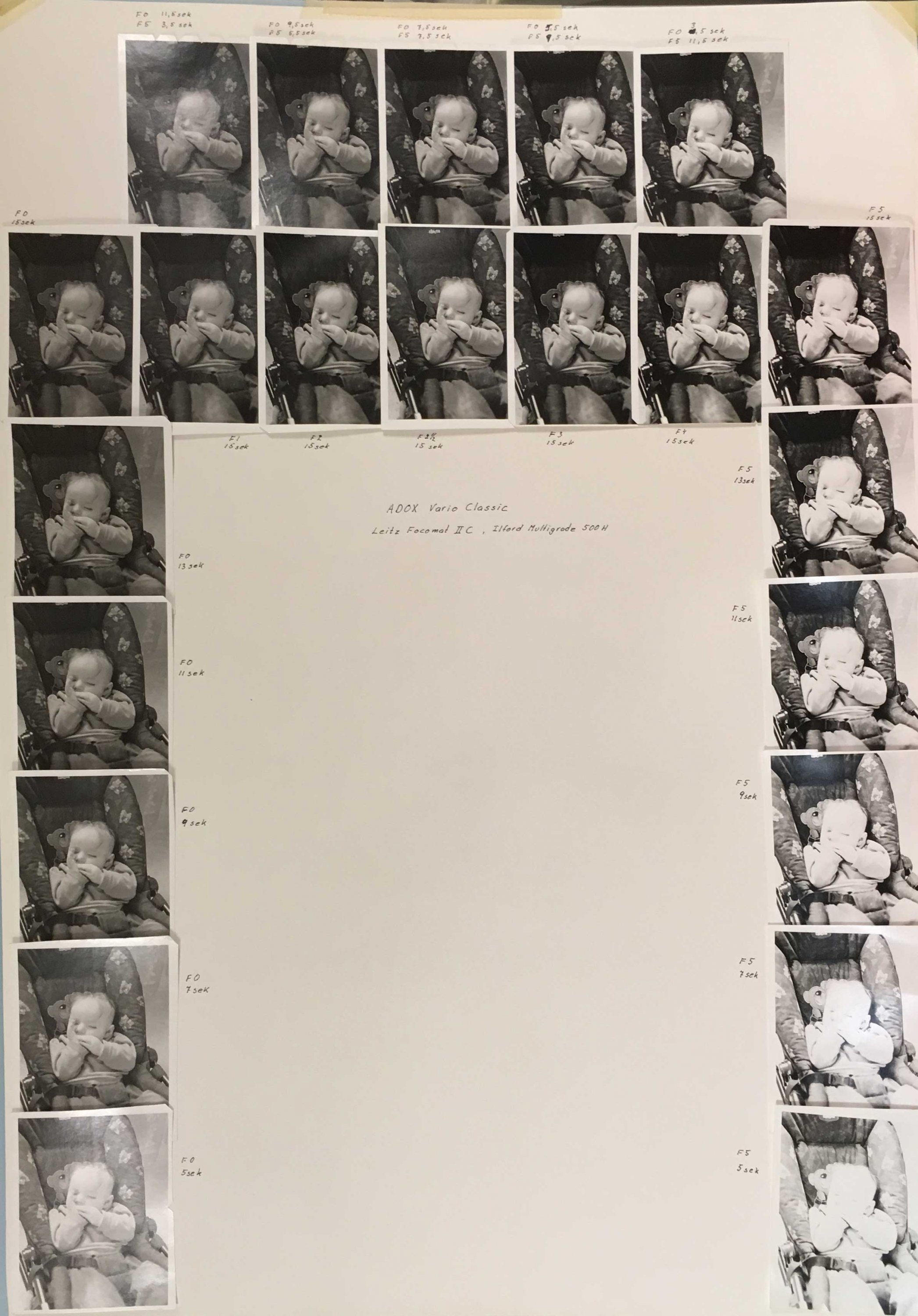

As a guide for contrast and brightnes variations for a certain paper with a certain enlarger/filter combination I made a chart with small prints , exposed with both combination filters and 0 + 5 filters . I varied exposure times for 0 and 5 filter settings to se the effect of dark and bright areas for both maximum and minimum contrast. In my own example ( se enclosure ) I used ADOX Vario Classic paper ( discontinued since a few years ) and my Leitz Focomat IIC with an Ilford 500 H head . The picture I chose is of my grandson as very small ( now ten years old ) and it was selected as it had a good variation of bright and dark areas. It takes some effort to make a chart like this, but it gives you a good feeling for the material you are working with. I hope you can se the filter settings and exposure times that are written close to each picture.
Karl-Gustaf
