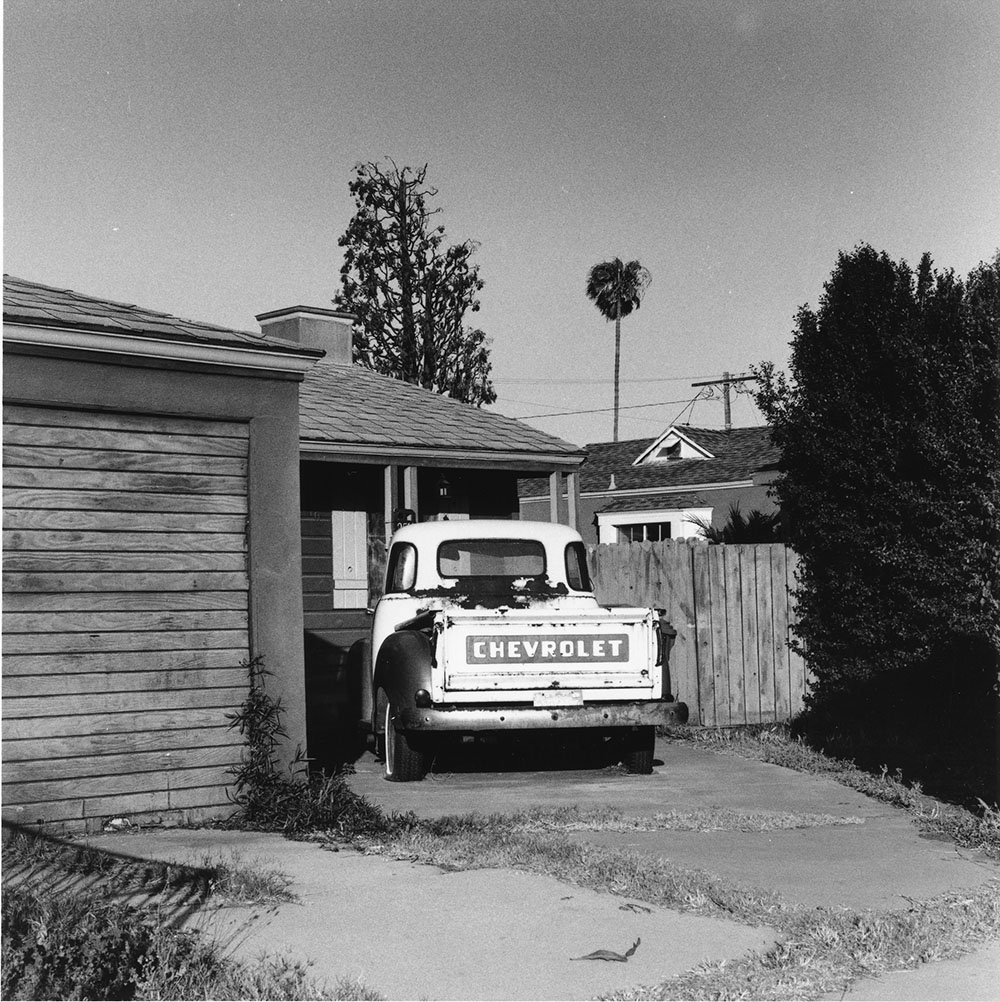

I only use 00 & 5 filters. I can usually judge from the test strips that I have made how much additional (or less) exposure of each filter I will need to get the tones I want in areas that need dodging or burning.
Fortunately, I keep notes on all my work prints. Not necessarily the best example, there wasn't a lot of doging/burning, but for this one, this is what I did:
I use an ND filter in the filter drawer to lengthen exposure time to make dodging and burning easier.
00 filter: 11.9 sec. + burn truck 1 stop (11.9 sec)
5 filter: 28.5 sec., dodge bushes 1/4 stop (7 sec.) + burn sky 1/2 stop (14+ sec),
This is a scan of the 8x10 work print. The final is a 10x10 image on 11x14 Ilford MG classic gloss fiber base paper.
