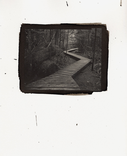

How do I stop spashing all over the paper? I like the uneven look of the brush marks and don't want to use a mask, but I always end up with these drip and spash marks that I didn't intend. Usually it is only a couple - this is particularly bad example.
I use a Richeson brush, fairly wide - 2 1/2 inch I think. I brush slowly and deliberately. I try to be careful, but seldom have a splash free paper. Any suggestions?

You don't really "brush"...you drag the brush with little or no pressure one way, then the next and so forth...

It looks like you're flicking the bristles as you lift the brush. Are you brushing too hard? You hardly need any pressure from the brush to get an even coating (try listening to the sound it makes while you brush - it tells you a lot about what's going on between the bristles, the emulsion and the paper).

I use a glass rod and get great boarders and use less materials. I always get a more even spread with a rod too.

That's cute actually :smile: May I suggest you practice on some cheap watercolour paper with another brush and some watercolours? I think I've never had this problem because I have quite a few years of watercolour painting in my past. If you look up watercolour techniques, look up how to do a "wash" because that's essentially what you need for coating purposes - a dry wash rather than a wet one usually but I guess it depends on your process and how humidified your paper is.
I wonder if you're possibly using too much liquid? Try gently pressing the brush against the side of the jar (if that's how you work, not sure if you use a pipette/eyedropper directly on the paper or not) so it's not so sopping and dripping wet with solution.

Have you tried using a sponge brush. I agree with what everyone has said. Apply less pressure and use less solution.

Those marks are from the bristles flicking emulsion. Don't bend the bristles as much and don't brush "through". Instead keep the brush at near the same angle as you pull it over the paper, and then lift it up before reversing.
