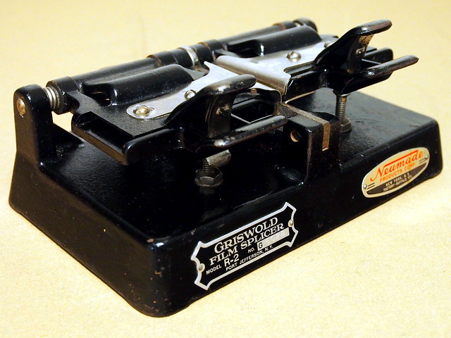

I'm slowly working up to having a well-working method of shooting 35mm in a 220 film back on my RB67, and part of the process design is to run the film from cassette to cassette, to allow unloading in daylight and, presumably, loading another roll (I expect to process all my own film for the foreseeable future).
To do this without fogging the last one or two already-exposed 65mm long frames when the film comes taut at the end, as well as to reduce the wastage at the beginning, I plan to splice leaders on my film. I have a roll of 35mm cine leader stock in hand, and have worked out a method of putting the leader on the tail end of commercial film (hint: the dark slide on the film magazine is your friend), but I need a way to accurately splice the leader. Sprocket spacing doesn't matter in this case, since the film is wrapped on smooth rollers and drives the fame counter by friction, but I need the splice to be correctly aligned (i.e. leader parallel to the film) and I need to be able to make the splice accurately and reliably in the dark (to avoid exposing the film tail).
I've thought about making up an alignment tool from poster board or mat board -- but if anyone knows of a better way to do this, I'd love to hear about it.
Also, am I correct in recalling that most 35mm films can fit up to about an extra foot (8 or so standard frames) of film into the cassette? The leader can hang out prior to loading, but there needs to be room for the tail inside the cassette.

I've got leader material at present, but I ordered it from Russia because I didn't find a US seller on eBay. Looks like Urbanski has as good or better price in short lengths; I've saved the link. And a splicer like that Griswold is exactly what I'm after -- nice, clean, straight cuts, even if I don't care about sprockets matching (no harm done if they do, though). Saturday's payday...
My Griswold doesn't have the nubs for the sprocket holes which make it hard for doing cine film but great for when I'm trying to cut my negatives between frames. Different cameras line up the frames differently with regards to the sprocket holes. I think there are other Griswold models that have the nubs for sprocket holes.
Urbanski also sells the tape but it sounds like for what you're doing Scotch tape may be a better option, especially if you want to take it apart easier.

In my case, I don't care about sprockets one way or the other -- there are no sprockets in the RB67 220 film back anyway. If the one I ordered has the nubs, it'll be a little easier to use in the dark, if it doesn't, that'll be okay too. Cutting negatives is a bonus, and I bet I can make an insert to guide the film over the nubs if they're present.

I bought the linked Griswold off eBay, and it arrived yesterday. That's one heavy piece of kit! Next up is to shoot through the roll currently loaded in my RB67 back (or unload it, though then there's 8 inches or so of fogged film from loading to account for), and measure exactly how much leader I'll need at each end of the film, so I can cut and mark a few pieces of leader stock of each length, and do a couple preloads.

Is the Griswald illuminated? How do you see where the frames are?
No illumination there, or needed. This would be used in a lit room, to add the leader to a new 135 cassette. The leader is connected to the spool in a takeup cassette (for mechanical reasons, this cassette has the spool inserted upside down). I'd then go dark, wind all the film into the takeup cassette, and turn the lights back on to splice a leader material tail at the end of the film (or, if I'm bulk loading, load the tail and splice on the film before loading the film into the cassette). Finally, if I've spliced a tail into commercially loaded film, go dark again and wind the film and leaders back into the original cassette. Now I'd have a pair of cassettes that I can field load into my 220 back.
The leader will get a start mark like the one on a 120/220 backing paper header so the film insert can time the start properly. Done this way, I should be able to get 17-18 24x67 exposures on a 36-exposure 135 roll, and have the last one protected inside the takeup cassette when the film comes tight, allowing field reloads without a changing bag.
