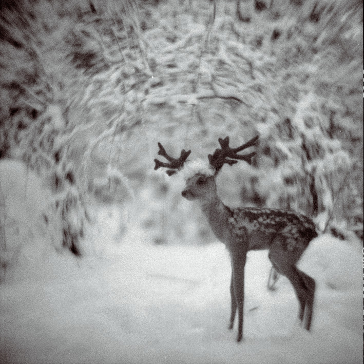

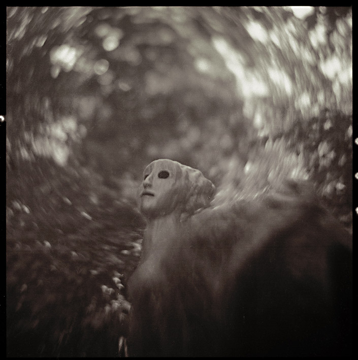

Large Format Pan
you say mf format (?)
best choise in my opinion is to get a Rollei SL66 - find a small petzval projection lens and fit it on...
Image done whith that combo.
(I like the images shown above... just showa you, you don't have to go big or expensive to get a nice result!)
