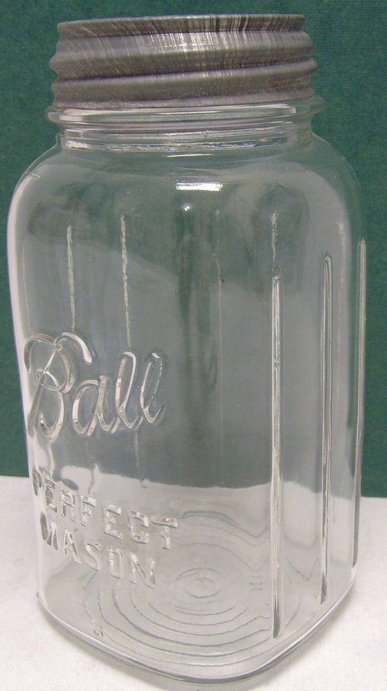

Mason jars?

If they are Free Mason jars you have to be square, don't you or is that just a British joke that fails to fly the Atlantic? 🙂
pentaxuser
There could be a connection.
A Mason Jar:
