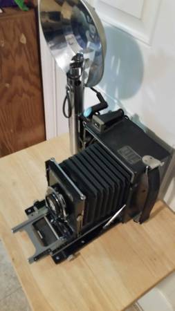

What is the condition of the cloth focal plane shutter?
Depending on the condition patching and repairing OR rebuilding could be necessary.

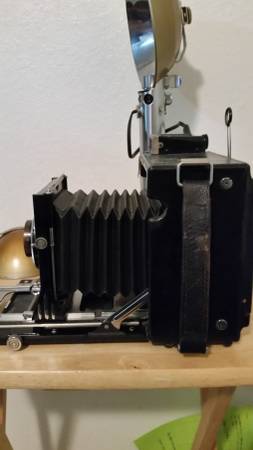

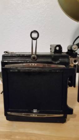

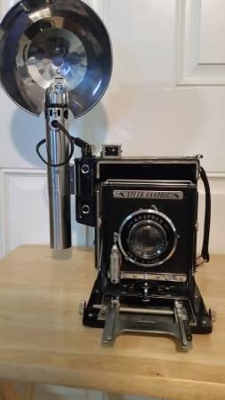

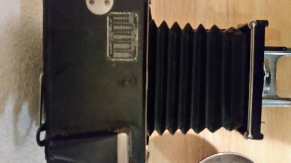

To be worth $400, for me the following would need to be true:
1. Bellows in good shape with no cracks or pinholes.
2. Lens shutter smooth at all speeds. Can be opened and closed smoothly (for when the focal plane shutter is to be used). Aperture should open and close smoothly.
3. Focal plane shutter should be smooth (not wrinkled), have no holes, and seem to operate properly at all speeds, on high and low tension.
4. Should have Graflok back.
5. Viewing hood should open/close properly.
6. Groundglass should be clean and free of scratches and chips.
7. Front standard should extend properly and rise, shift, and tilt. Bed should drop.
8. Pulling the standard out to the infinity stops and scale focusing to infinity, the rangefinder should agree as well as the image on the groundglass. Focusing at closer distances should also agree.
I know nothing about the flash or solenoid.
When I see something like this, I want to check it out in person - unless I know the seller is totally knowledgeable about the camera.

No, not 400, no way. It's an Anniversary--there was no such thing as Graflok. 250 in good to VG condition, maybe.
True. But some Anniversary models were modified for the desirable Graflok. I can't tell from these two photos.

I would pass on that one, looks to me like a good candidate for a hefty repair bill. That might have been sitting on a shelf for 50+ years...so nearly everything could be locked/seized/dry-rotted/crumbled/fogged/etc.
A Speed is not a small camera and will take all of the same necessary 4x5 infrastructure to support it as the Calumet did/does, IF you want to actually use it.
Are you completely sure you have exhausted all other potential ways of creating the images you want to create with roll film cameras? It is not an easy step to sheet film and more importantly, a completely different way of using the camera/putting film through it.
Not something as easy as just going and buying another camera.

1. Its an Anniversary Speed Graphic, 4x5 format. $250-$275
2. Lens in shutter, unknown type, $75-$125
3. Unknown brand 3 cell synchronizer with 7 inch reflector $125-$250 as it looks similar to the light saber models
4. Focuspot $50-$75
If it comes with a case and film holders then it might squeak by at $350 for the kit.
I charge $175 to CLA the body and RF, any parts that need to be replaced are extra, the front (lens) shutter is another $85 so that's $260 more if it needs the servicing and could run another $125 to recoat the shutter curtain if that is needed.
With the chrome trim its a 1939-1940 or a 1945-1946 vintage.
To check the shutter curtain for pin holes open the front shutter on T , aperture wide open or remove the lens and board, run the curtain down to closed after O, point the camera at a bright light source and monitor the ground glass while winding the curtain slowly. The only time you should see light is when one of the curtain apertures passes the ground glass.
