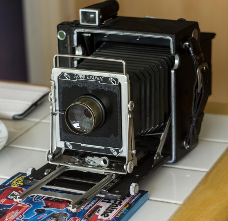

Hi all,
Just wanted to post this up with regards to my DIY lens building/large format fun, I still need to make some waterhouse stops for the lens however I can use the speed graphic focal plane shutter to use this lens, I am just working out the last parts of making the lens work with the body. The lens is much larger than a standard lens board.
Its on slightly raised runner so that I can use the OEM focusing mechanism rail
Image on the ground glass on test focus
I plan to fit some bag bellows or add a sliding box arrangement to bridge the gap between the back of the lens and the body but its almost there.
Front element is 4", very fine DoF, should improve once stopped down though - f number and focal length were worked out owing to the less than orthodox construction!

Great stuff. Is that a projection lens? I have a spare one of those I want to do something with. I also am building a FrankenGraphic (Crown) from spare parts. Almost there (as they always say).

They sure do lol I just wanted to try this out, the image circle is massive so I could use this for ULF at some point in the future, actually quite happy with the image that its produced so far though.

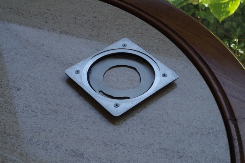

For mounting, you might refer to my older thread "Graflex lensboard lock hardware"
which show one of the heavy duty laminated aluminum boards and beefed up threaded hardware I made for the 4x5 Speed to support the large diameter heavy Takumars during hand held use.

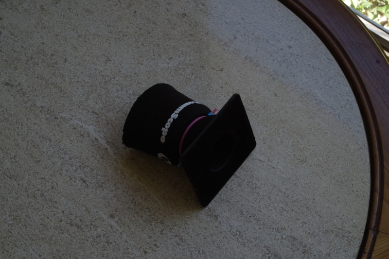

Also one time I made a "Sock Lensboard" of a thin plastic board with a 40mm bore on one side and a beer can holder (wetsuit material) which stretches up to 80mm or more to attach to barrels (see photo below). Very simple to make, it clamps with cable ties, but I think the one I made is too small for your lens.
Anyway.. Hope you find a good way to couple that lens so that it is sufficiently light tight.

Thanks for the info, I was thinking about a rubber of some sort to put over the end of the lens to attach to the body, I will have a look into a lensboard attachment like the one you have shown, I could simply put a cover over the gap, or indeed attach some blackout material to the front of the lens and drape a cape over the whole thing (would also help with focus etc as well).

@m1tch - what as a matter of interest is the lens element from?

Thanks for the interest guys, I have just got myself an RAF 20" f6.3 aero lens as well which is larger lol but this lens is much faster, here is the secret to my lens:
The DIY lens is simply two 100mm 2X magnifying lenses and a plastic plumbing pipe connector (also the standard 100mm fitting), using just 1 lens would mean a much longer focal length, took me a while to work out what dioptre lenses would work to get a useful lens that would be compact enough to use.
The lens has a razor thin Dof when wide open like that - gives an almost 3D effect on the ground glass, I will simply use some waterhouse stops to dial it down a bit, even though the speed graphic can shoot to 1/1000 is might still be a bit too slow lol although I am planning to use paper negatives and shoot headshot portraits with the lens setup.
