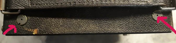

"shutter mechanism always has a sort of rattle-y sound to it. "
That rattle or perhaps better called a squeal is to my understanding no lube where the shutter curtain roller shafts meet the bearing supports on their ends in the body. graflexoil.jpg . Clean out dust from the curtain area and one drop of light machine oil in each of the holes shown and their respective positions on the opposite end will probably help that noise in my opinion. Its not a full service but it may help.
