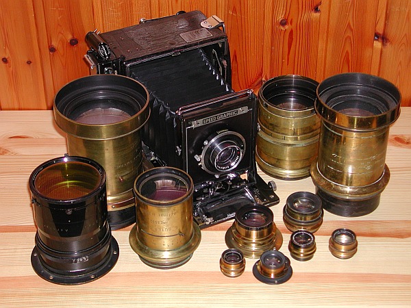

An old Speed Graphic, some old lenses...
I could have sworn I had a picture of it with the universal iris lens board, but I didn't. You'll just have to take my word for it that I have one - I found a small iris holder in a big box of (mostly) junk, and screwed it on a lens board. It takes any lens between 6 and 60mm diameter - that's enough for almost everything.
