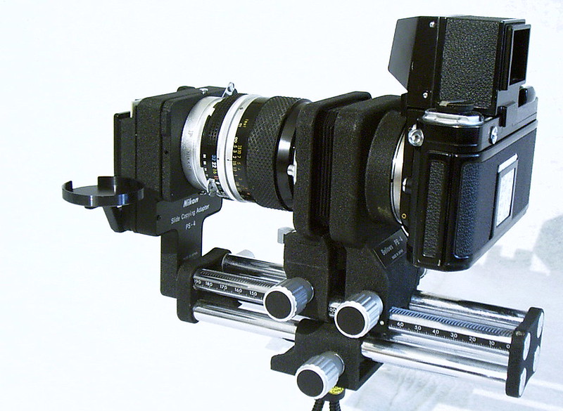

I used a "speed finder" (also called a sports finder or an action finder) on my Nikon F2 slr. I tended to use it when I was shooting sports, macro, copying slides, wearing protective eyewear on a gun range, wearing protective goggles in a laboratory, or wearing a helmet with protective eye shield.
Nikon Slide Copy
by Narsuitus, on Flickr

I used a "speed finder" on my Nikon F2 slr. I tended to use it when I was shooting ..., macro, copying slides, ... .
Though for these two applications a much cheaper right-angle finder would suffice too.

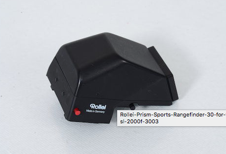

One of the most expensive and difficult to obtain...
And one of the strangest...
Similar to the wire finder on a Speed or Crown Grpahic, used for sports and news when shooting at infinity. Works rather well.
By principle a a wire frame finder, in a FL-adjustable version.
The "strangeness" flows from the cameras it fits on, not the finder itself.
Even a Speed or Crown Graphic seems more appropriate for sports use than an RB/RZ/67.
