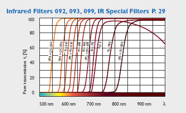

Here are the spectral curves for B+W IR filters from their filter handbook (downloadable from the Schneider website).
If B+W 092 is the same as your Ilford filter this should give you the info you need.

Doremus,
Thanks.
I was not aware of that site. Eons ago I bought a number of there special effect filters... nice to see they are still going!
I don't know if that filter is close to the SFX200 filter or not, but we may find out eventually, one way or another.
Anyway... it is still good to see B&W's data!

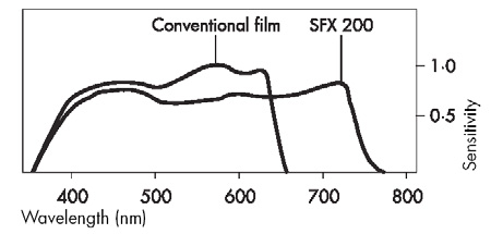

Ray,
I looked at my own files and found this (Apug again...):
oldfaithful58,
I appreciate your effort... but I guess you know I was asking about the filter which goes by the exact same name :surprised:
The film spec sheet I have ... (the film I will have on Sunday!) All I need now is to make a final filter choice.... Thats why I'd like to see "SFX200 the filter" info... but it occurs to me that the data might not be published.
Thanks, though.
