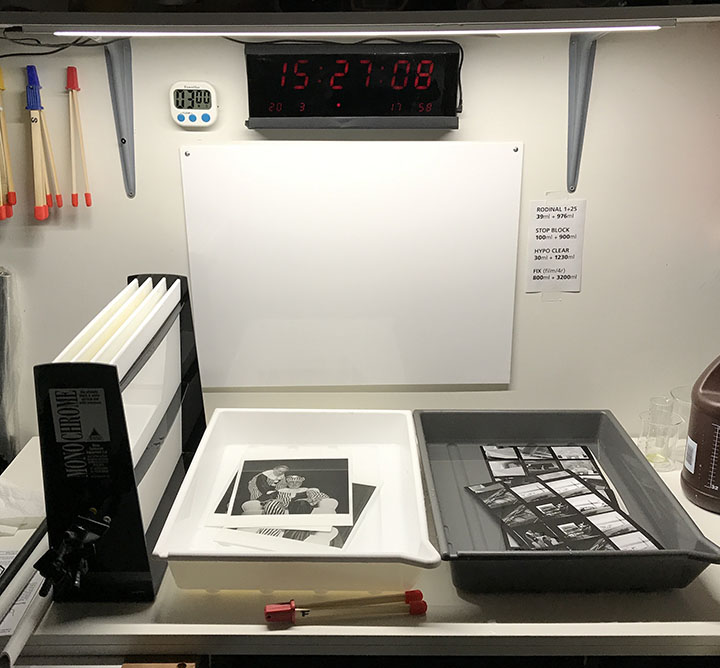

I believe it is a Feit Electric bulb from Costco. I have seen it with PAR recessed ceiling fixture bulbs quite a bit. The ceiling fixtures in my living and dining rooms are on a dimmer and take 15-30 seconds to even light up. Others I have light up and turn off immediately. I use an under-cabinet LED strip I bought from Amazon that works great as an examination light in my darkroom. Nice feature is it turns on and off with a touch switch, easy to do in the darkened setting.
