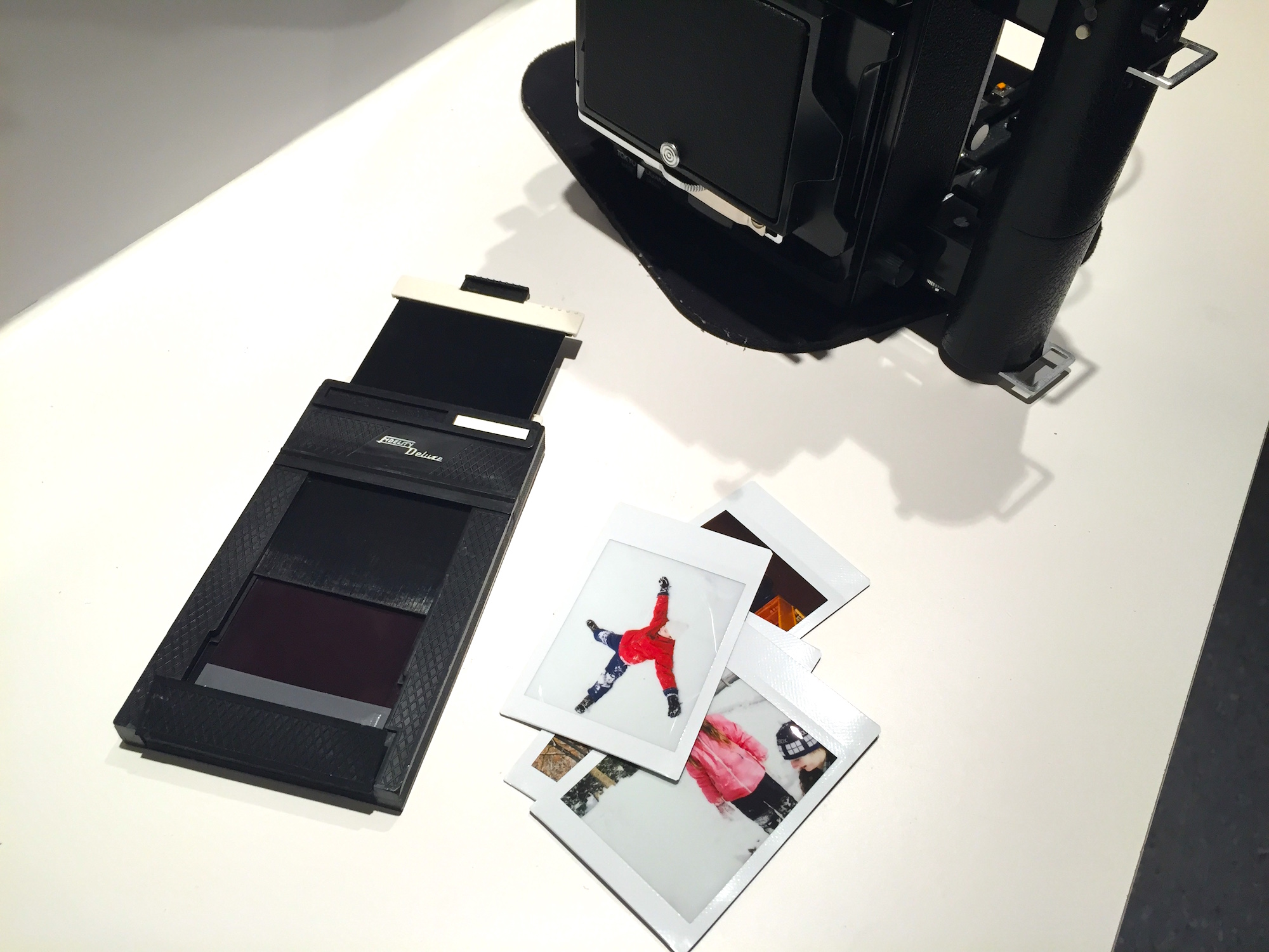

I only have 5 boxes of FP100 left, but I have unlimited Instax! For the last few years I shoot Instax like sheet film and process it in the Instax camera. A huge advantage of the film holders is that they place the Instax film in the correct location so both the ground glass back and the rangefinder provide correct focus.

I'm also experimenting with spent FP100 cartridges and loading them with a single Instax film and using the Polaroid back film rollers to do the processing (manually pulling, rather than motor)
