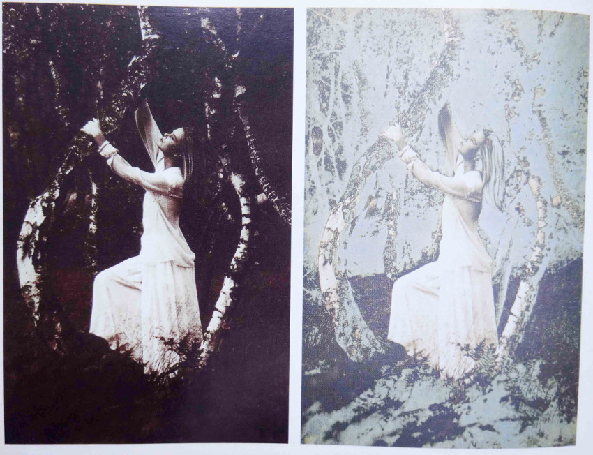

Sticking my neck out on this one! (last time I posed on this subject (about 15 years ago) elsewhere, I received a massive slating.) so here goes....
With the advances in archival techniques, particularly in B&W images, in the analogue domain and digital imaging storage systems, archival stability is no longer a major issue in photography. In the 1990's I explored a number of techniques, some historically well established, some possibly new, to deliberately produce physical images that changed with time, or changed according to viewing angle or angle of illumination, hence the term 'spatio-temporal kinetic'. Some images were deliberately changed or manipulated on stage as a live performance.
Below is an example of a spatial kinetic image published in the BJP, No 6946, 28th October 1993, The Kinetic Tin Process. These are two shots of the same single print viewed from different angles taken from the BJP article. The original print was given away many years ago.
Anyone interested in exploring these concepts?

interesting concept.
so in essence the print changes depending on how one looks at it
like a daguerreotype changes from negative to positive ... depending on how light strikes it ?
you mention something about archival stability it is, but it isn't but is ? i am a bit confused
this print that you uploaded ... as time marched on, would the "2nd image" evolved into something else
or is it static, and does the print in its end state de-evolve ( evolve? ) into a grey ( or black) print ?
i ask these questions because i make retina prints, as Nicéphore Niépce did by long exposing a
sheet of light sensive paper ( or film or glass ) in a camera sometimes for days. depending on the paper
and the light, the length of time it was exposed and if i soak the paper in developer or something and let it air dry &c i get
a negative or positive image which is stained and trapped in the emulsion and which changes over time
to grey or black or something else, but there is no static record of the original image like the one you posted
( unless the images on the left and right eventually shift to become something else totally different ).

Thanks for your comments. In the above image I was exploring the effect, as you say, like a daguerreotype, but on a standard silver gelatine paper print (Ilford Multigrade III FB). The predominant kinetic effect was 'spatial' - a change of visualisation of the print according to viewing angle, or angle of illumination. The print will gradually transform between viewing angles, its not an 'either /or' state. The change of image through time was not a consideration in this chemistry, but the image was likely to change over a time span of decades due to a number of factors - this was a secondary effect and not the main focus of the experiment. So archival stability through longer periods of time (as opposed to minutes, hours, days) was not a major consideration in this process. As I do not possess the original print above from which the journal images were made, I cannot say how the particular image above has evolved through time. But other examples using similar chemistry do slowly change slightly in colour and density, but do not fade out so far (approx 14years). Incidentally the 'light ethereal' reflective state (right image above) does slightly intensify on storage with some prints. So far none have de-evolved into grey.
I hope this answers your questions. Please do not hesitate to ask if you wish to know any more.
hi again
thanks for your clarification !
the way you have described the process sounds almost like
an image that has "silvered out" an old polaroid #55 print that has
reflective blacks on it depending on how it is looked at
and /or a toning process that rockland colloid makes called halochrome.
where the image looks like a traditional silver print until you see it from a different angle and then
it has a different quality ...
i haven't seen any halochrome prints in the flesh but i do have images that are silvering out do to a variety of
reasons i dont' fully understand ( atmospheric contamination? being trapped in a frame so the print can't out-gas ? )
and i don't have any that have fully vanished or entered a state of equilibrium.
it would be interesting to see the prints in your post today to see what they have e/de-volved into..

Yes. The Tin Process, which is a complex and carefully controlled bleach / light exposure / redevelopment technique to create a very thin semi-reflective layer on the surface of the print that is correlated to the silver density of the original print. It uses techniques similar to halochrome, but using different chemistry and is a very refined and delicate implementation of the chemistry as such. There are many variables involved.
I've not done this for over 20 years so I don't have any 'fresh' prints to upload.

I have observed that if I look at the emulsion side of a negative strip and hold it just right with respect to the light, I see the light reflected off the emulsion instead of the light transmitted through it - and I see a low-contrast positive image rather than a negative. It isn't always easy to do, perhaps the film stock or how well it was processed matters?
Yes this is a whisper of the effect I am referring to it is an important aspect of the perceptual differential of the reflected / transmitted light image. Special processing can magnify and enhance the effect on a black and white print as I posted at the start of this thread.
These effects are often seen in old black and white silver gelatine prints decades old and are 'accidental' phenomena relating to ageing processes in the emulsion of the print. My intention was to 'engineer and enhance' the effect as a desirable creative property of the print rather than a curio or accident due to long term storage. Its the shift of thinking that purports that kinetic phenomena can be a desirable creative component of still photography, rather than undesirable accidents detracting from the sacrosanct Holy Grail of total archival permanence, that I am concerned with. Deliberately engineered (rather than accidental) temporal effects - prints changing through time, is the other element of 'Spatio Temporal Kinetic Imaging'. And yes this phenomenon goes back to the very inception of photography and the 'problem' of permanence.

I'd love to - BUT its a matter of finding the time and digging out my old notes from over 20 years ago. Checking my old chemical stocks to see if they are still usable. Also the prints are quite difficult to produce! And I'm not sure that currently available B&W papers will respond in the same way ;-)
However... watch this space...

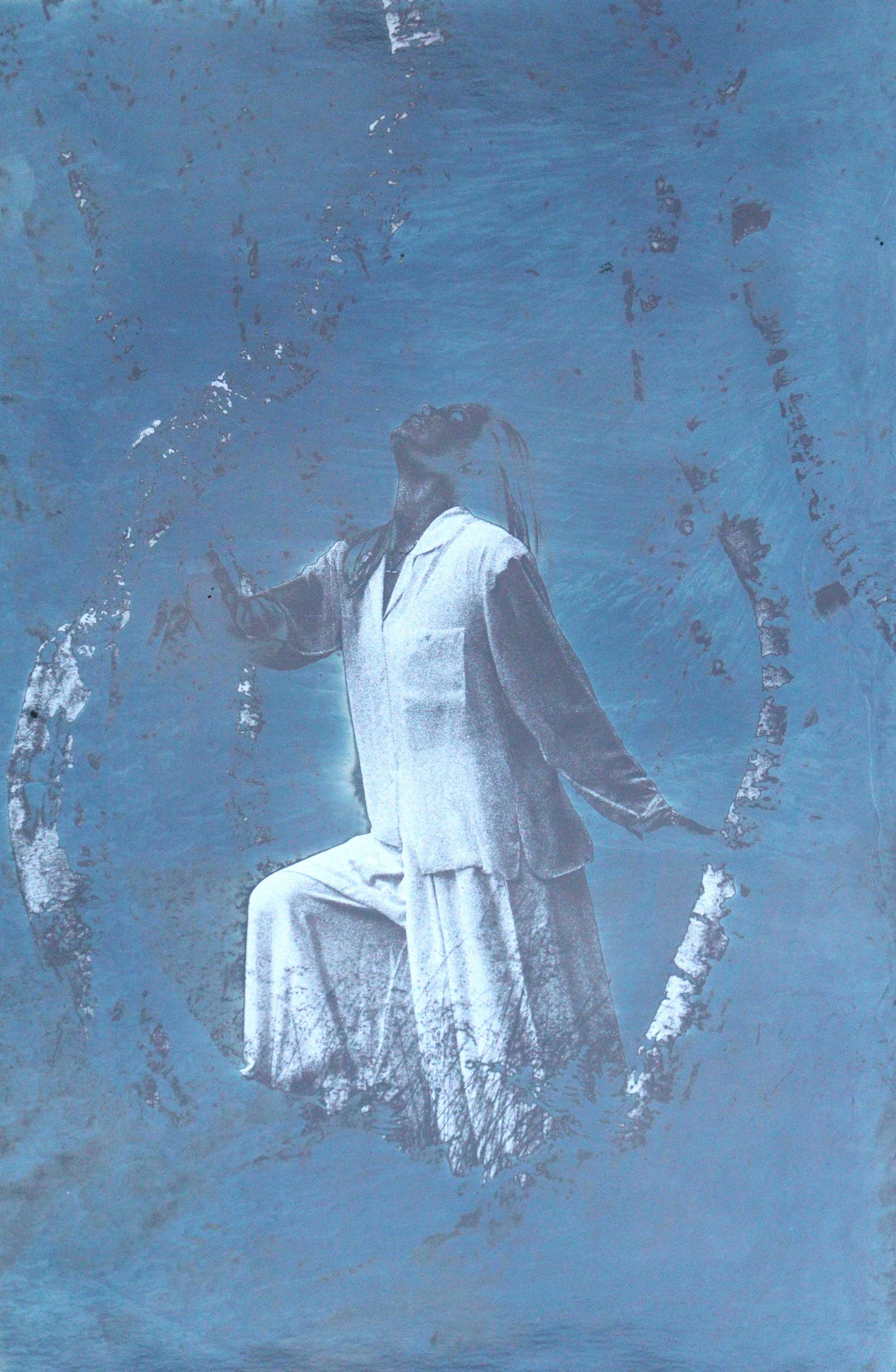

Just to let you know - I resurrected the 'kinetic tin process' several months ago, using the same negative as my original prints. It was difficult as my original notes were not as detailed as I thought and I had to use a different paper. Here are two photos from the same print viewed at different angles. There are surface marks on the image that appeared as a result of the process giving each print a unique patina. These can be avoided, or at least minimised, with very careful handling during the long processing sequence.
I have a video of viewing the print as the angle changes to show the dynamic change from one visualisation to another. If there is interest I'll post it, or give a link.
Here is the video on vimeo. The print is turned on its side to make maximum use of the horizontal video format. You can see clearly the differentiation of the reflected / transmitted image and the kinetic transition between the two. This is much more subtle than the Mirror effect. Note that the reflected image requires light strong in blue / violet wavelengths, like daylight. Under tungsten the effect is weak to barely perceptible. And many thanks to model Diane Hallam.

You are most welcome jnantz / John. I apologise for the long delay. I have learned a lot from this group and been inspired by the comments too.
For those interested in the Kinetic Tin technique, B/W prints must be made on FB paper, it uses a ferricyanide / chloride bleach to completion, light exposure, a two bath redevelopment using 1) stannous chloride / hydrochloric acid and 2) dilute ammonia. The redevelopment stage is critical, delicate and can take up to an hour. The exact details have never been published publicly, but offered privately to individuals who wish to use the technique.
