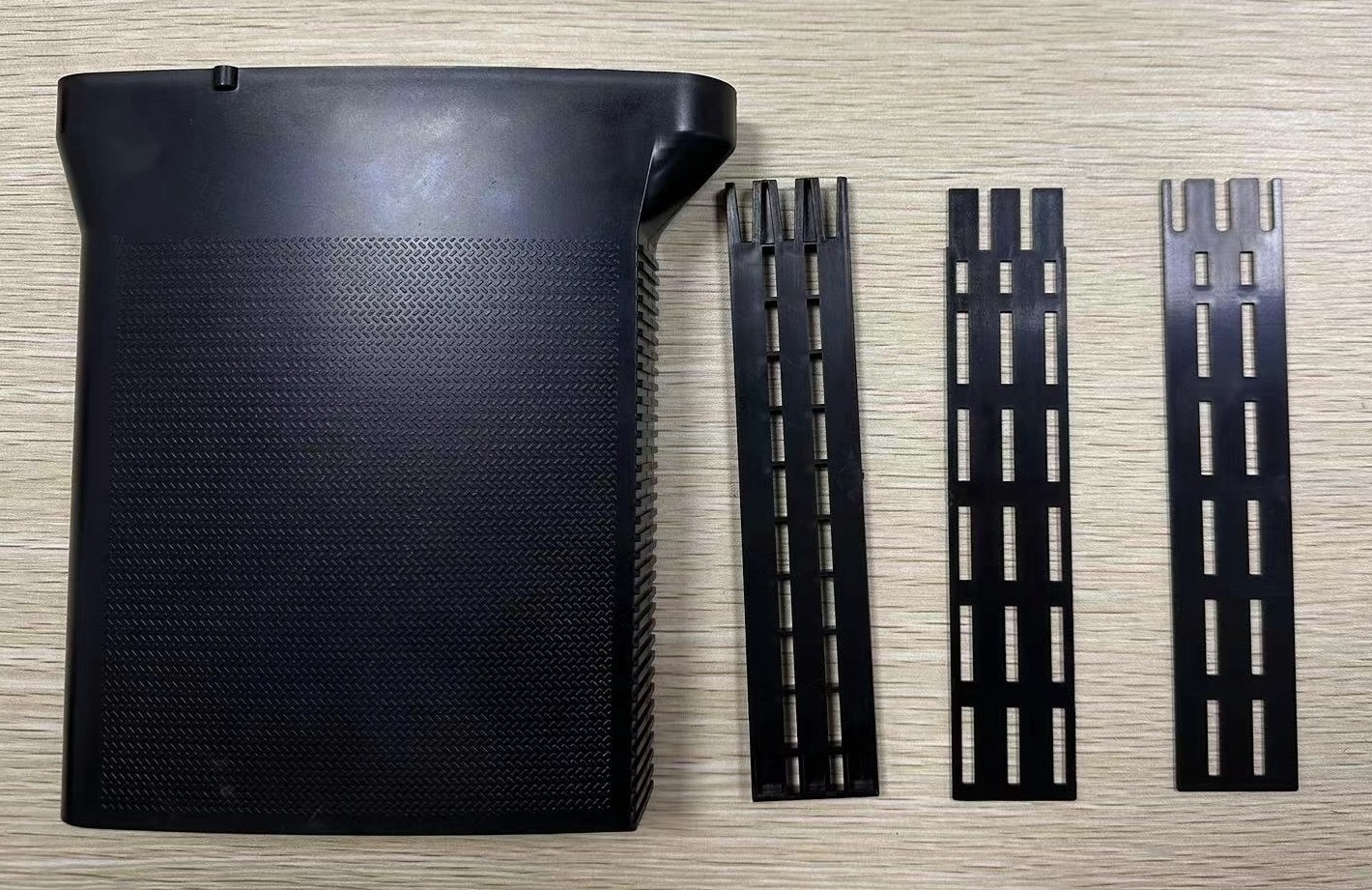

Photos of the first prototype out of the mold!
Note the heavy "diamond plate" texture.
We should have samples for testing early next week; production (if all goes well), mid-May.

Wow. Half the film capacity of my Yankee Agitank, but with less than 1/3 the liquid required. But for four times the price...
