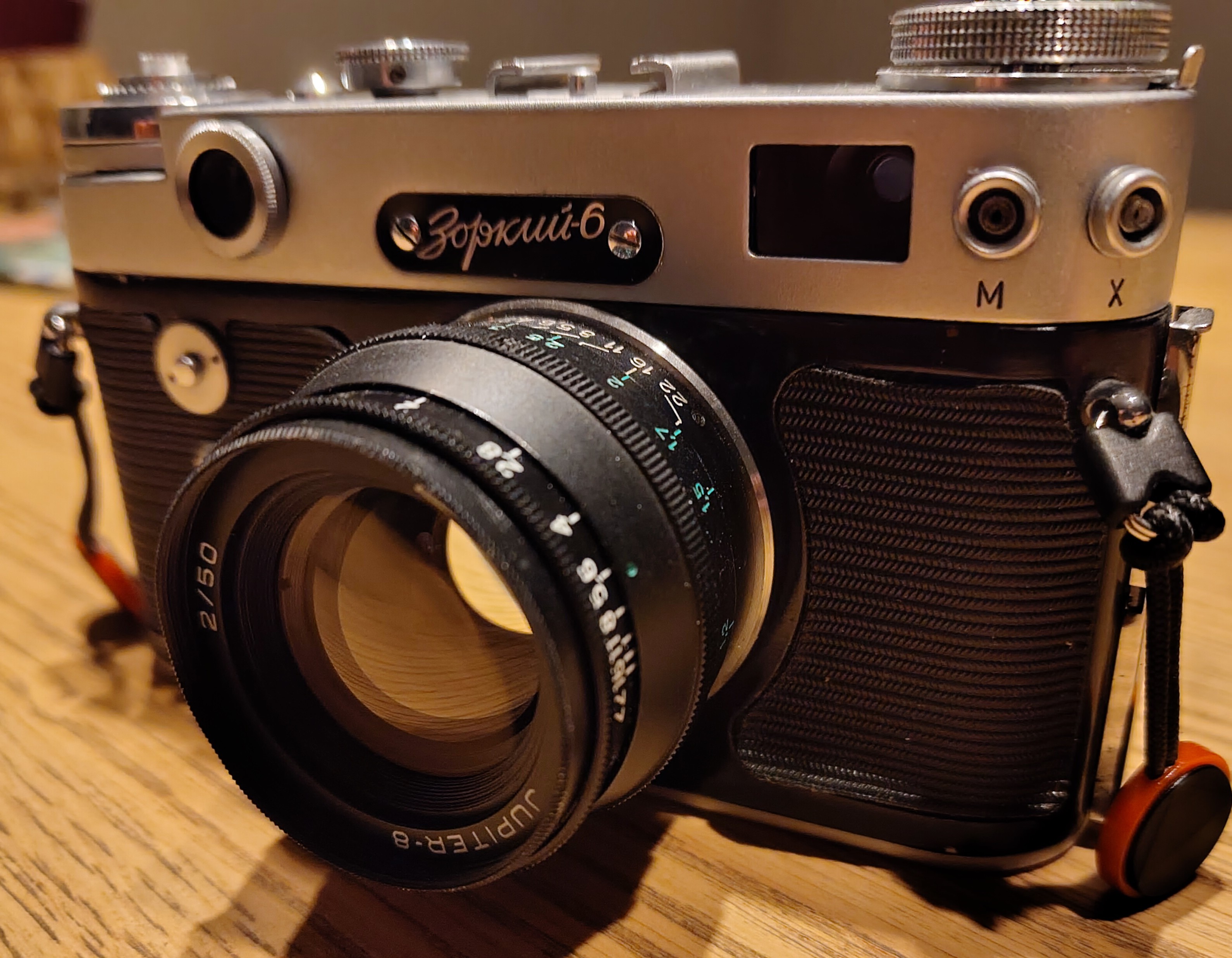

I've got this one
Maybe i'm a moron.... Maybe it's just the paint that makes me think the lens is made of plastic. It feels also lighter than the silver/metal versions,
I can't tell if it's plastic from the picture but it's the alignment of the glass that matters - possibly involving an element of luck. My J-8 from around 1960 in contax rangefinder mount is super sharp and accurate to focus, I don't hesitate to use it wide open. That may be lucky, as well as me possessing a Kiev 4 without issues.
