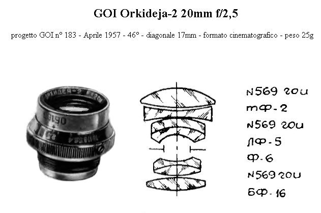

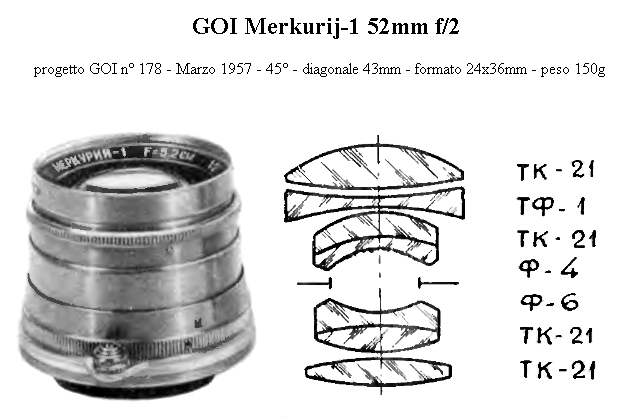

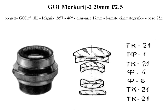

These are 1950s Summicron Copies , Glasses reaches to 1.667 or more. St Petersburg made. 20 and 52mm. 20mm is so interesting for me it reeaches 120 lp/mm at the center but fast to drop at the corners.
Where to look for buy online - not so in love with ebay for such a old lens - ?
Is there any user , photographs ?

What would you use the 20mm f2.5 on? It is a movie camera lens, probably a 'C' mount. That will in no way cover a 35mm frame at infinity even if you could mount it close enough to the film plane.
It says right in that first and last file: Cinematographico so those are out for 35mm use.
Middle looks interesting, maybe a Jupiter-8 evolution that never got made in big numbers?
Not likely. The diagram is that of a double Gauss variant; the J-8 was a classic Sonnar - a direct clone of the 50/2 Zeiss lens designed by Ludwig Bertele in 1931. Bertele was also responsible for the fast Ernemann lenses, which were the ancestors of the Sonnars.
