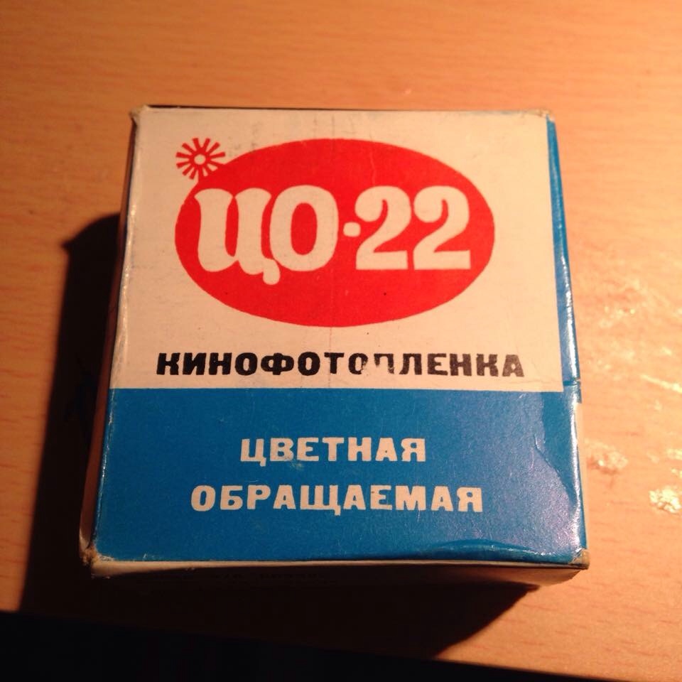

I recently got a Soviet-built Quarz 8mm camera and this unused film came with it. I can't read the script, but others have deciphered that it's color reversal. Would this take E6 processing?
Photo Engineer
Apr 19, 2005
29,018
Rochester, NY
Take a small snip of film and soak it in 100F (40C) water. If the emulsion washes off, it cannot go through E6. Even if it does not, this does not assure E6 compatibility but if it does, it says NO.
If it washes off, it is either E4 or proprietary which is similar to the old Agfa reversal process.

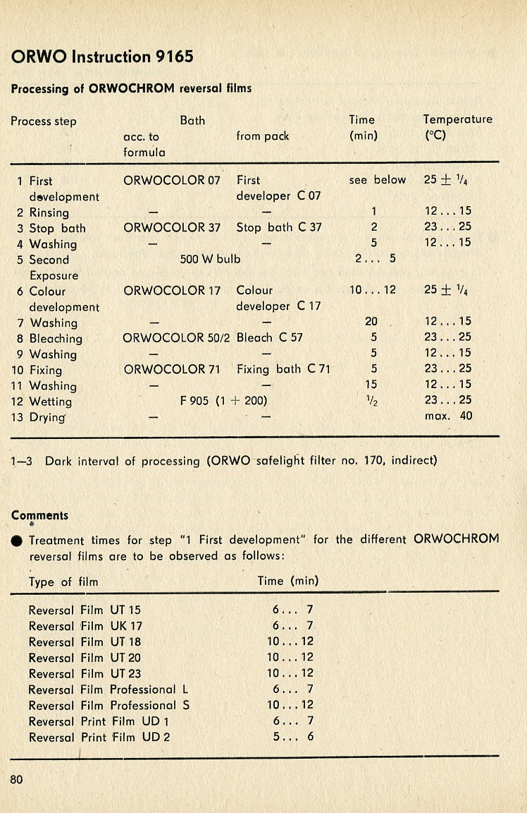

That looks quite similar to the ORWO process 9165, which gorbas posted already. I’ve attached the ORWO process 9165 with the chemistry again. ( H 142 = Hydrochinon, A 901 = Natriumtripolyphosphat)
It comes from the book “fotografische Chemie” by Junge/Hübner 5th edition VEB Fotokinoverlag Leipzig 1989. It also contains a short translation of the most important Russian chemical names.
ЦПВ-1 is „N,N-Diethyl-p-phenylenediamine sulfate“
