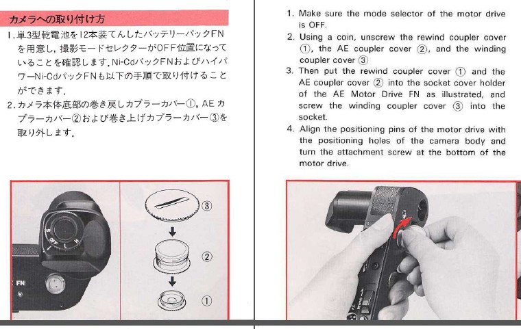

Did you tried this:

Tony-S
Tony-S
Aug 16, 2009
1,145
Colorado, USA
Darn it, David. You had me all excited that I might have them, but unfortunately the stowage site is empty. I may email KEH to see if they might have them.

The best source for these items is eBay, but the sellers always want an arm and a leg for them because they know how rare they are. If you buy a New F1 you should ensure these screws are present.
benjiboy
Apr 18, 2005
11,970
U.K.
The correct term for what you are after is a rewind coupler cover, you stand a better chance of getting one if you know the correct name for it.
