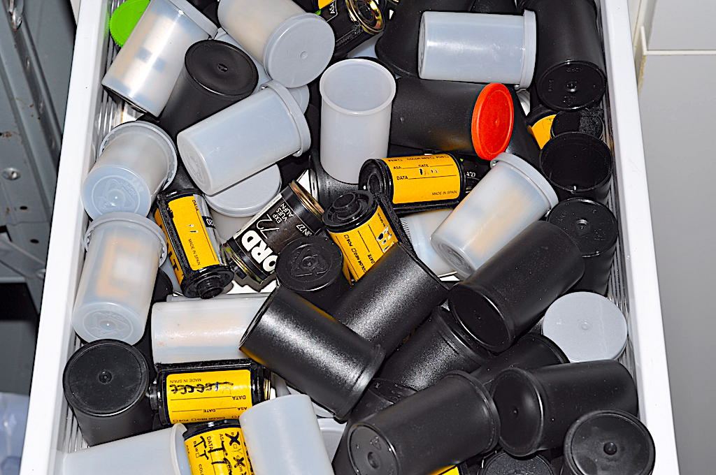

What is wrong with the plastic ones sold by B&H? I'm still using the metal ones I got in the 1980s but would like some new ones. I used to scratch marks on them each time they were used and then throw them out but I stopped doing that about 20 years ago, seeing as replacements are hard to come by.
They shed. The plasticy "felt" material is cheap and deteriorates on contact, filling your camera with tiny plastic fibers. Also they tend to pop open when dropped. This horrendous quality is a relatively new phenomena though, I still have a few identical looking plastic cartridges from maybe 5-ish (?) years ago, and their quality is vastly superior.
