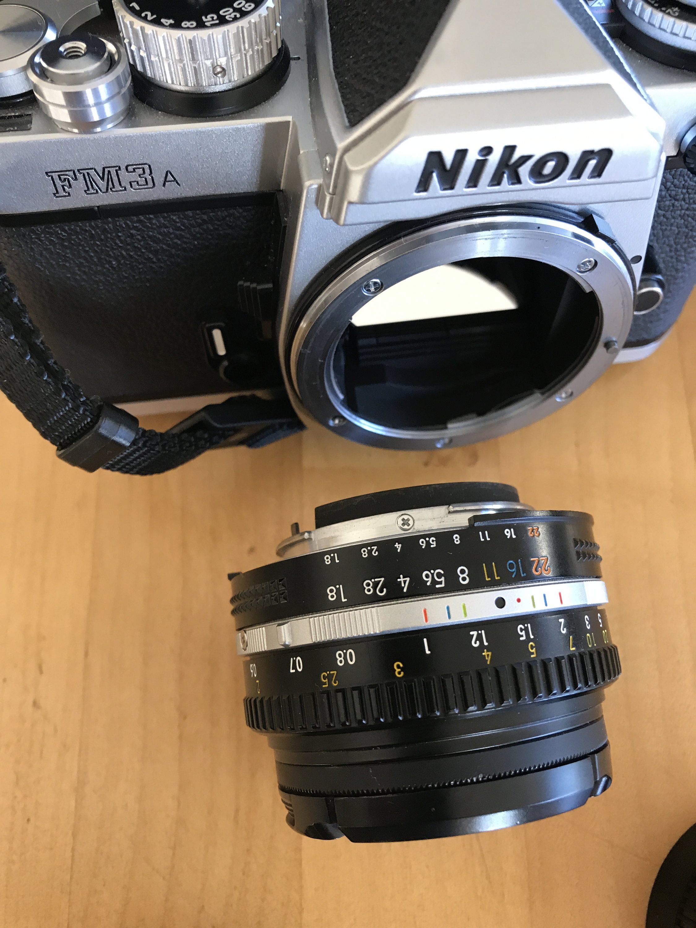

The latest 50mm f/1.8 AIS came from the factory sans bunny ears. There were others.
Probably easiest, cheapest and fastest way to get replacement ears is to scavenge some from a junk lens from eBay.
Might have to resort to that.
Did the lenses that didn't come with the bunny ears have holes in the lens barrel for the screws, or were they sans holes?
BradS
Sep 28, 2004
8,113
Soulsbyville, California
No holes...

Trivia alert! That is the Nikon 50/1.8 AI-S "compact" version that came after the Series E lenses. It is short like the Series E, looks like the Series E second version, and doesn't have a non-AI coupling prong, but it isn't marked Series E. These often came as normal lenses in the FE2/FM2 era. Like this: https://www.destoutz.ch/lens_50mm_f1.8_2257006.html The earlier 50/1.8 AI and AI-S are longer, like this: https://www.destoutz.ch/lens_50mm_f1.8_3209712.html You can browse the versions of these lenses at http://www.photosynthesis.co.nz/nikon/serialno.html#50slow
This 50/1.8 is the only fairly usual Nikon MF lens I commonly see that originally came without a coupling prong, besides the Series E lenses. There are unusual lenses like the PC lenses with a preset aperture ring, which don't have any meter coupling and no prong.
