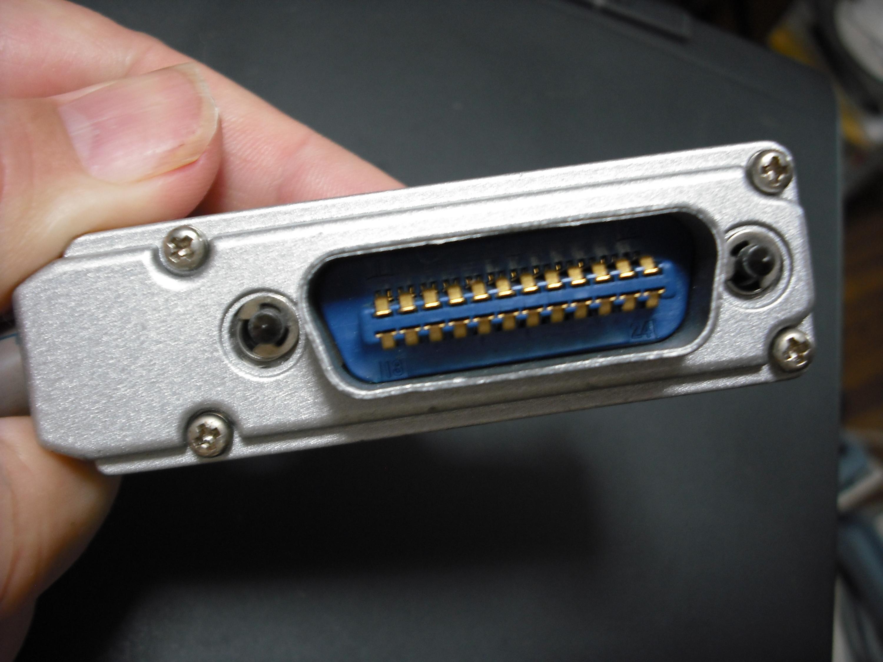

Ray Rogers
Aug 27, 2005
1,543
Earth

Ah, yes. The good old GPIB interface. As a parallel bus, it's not directly convertible to serial. Check out National Instruments, they probably have the largest support for GPIB, including (at one time, at least) a free library for developing code to support it. The downside is, this stuff is EXPENSIVE if you buy it new. A better bet is to look for a used card out on one of the Internet dumping grounds for stuff (i.e., 'the bay'). If you have a card, NI is pretty good with support.
Ed

Ah, yes. The good old GPIB interface. As a parallel bus, it's not directly convertible to serial...A better bet is to look for a used card out on one of the Internet dumping grounds for stuff (i.e., 'the bay'). If you have a card, NI is pretty good with support.
Ed
Card... What's this? Can you explain your suggested approach in more detail?

Sure, it's an add-in card for a computer. They are available for the 'old' ISA or the newer PCI or PCI-E busses. You then use software on the computer to read and interpret the data from the device (in this case, a densitometer).
I'm not sure exactly what you are trying to do via the cable.
Ray Rogers
Aug 27, 2005
1,543
Earth
I want to connect a densitometer
(wh. has the cable in question built into it-male connector)
to a laptop (which has an RS232 type (female) connector.
Software then feeds the measured data into excell.
