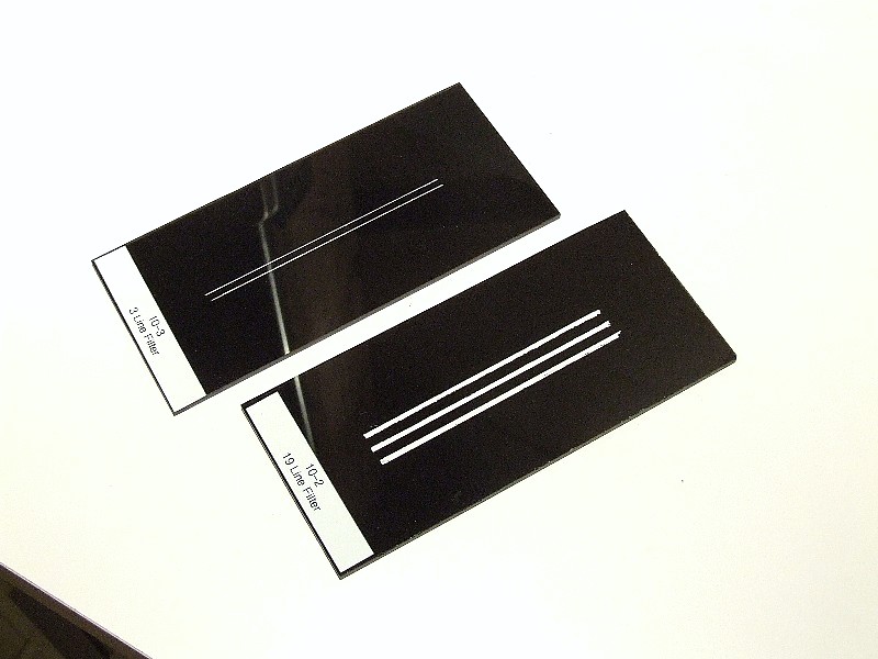

For example these are the neutral density filters for one of my sensitometers. They are not dichroic. They are opaque with clear areas. They don't fade or change the color of the light.

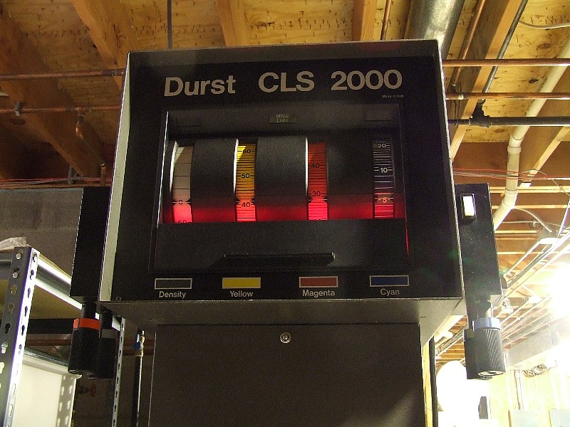

On the Durst, the Density (Light Intensity) is an opaque metal shade parallel with the color filters. It is not a neutral density filter.
