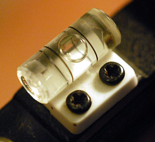

I have an old Cambo 5x7 which has two broken spirit levels. Anyone know a good source for them?
Not sure if the proper name is "spirit level" or "bubble level"... maybe those terms are synonymous?
Are these "generic", or do I need a Cambo brand in order to fit the standard and screw holes?
I know I don't need them, but if they are inexpensive and available I would feel better having them....
Thanks,
Keith Ostertag

Look at a DIY store for tools with a spirit level. If there is one with a small levelling tube, buy it, take out the tube and cement it on your adjusting plate.

A spirit level is as accurate as you adust it.
Only problem would be the bubble size. I often came across too small bubbles. In this case add new marker lines, so that the bubble can be adjusted just between the two them.

Thank you gentlemen! I hadn't thought of obtaining the tubes only... might take some careful adjustments to get them glued with adequate precision... but I think I will try. Thank you very much for these ideas!

I'd thought the baseplate of that level had some swivelling to adjust the level. If not use fast curing epoxy cement, yielding you a minute or two to correct.

McMaster-Carr have dedicated holders for the tubes. One can screw/glue these holders to the camera. If necessary shims could be used.
If one uses a selfmade holder one can use fast curing epoxy cement to fix the tube to the holder in final position. By this one can adjust levelling of the tube during curing.

A couple of the bubble levels were dry in my old Sinar P. I went to the hardware store and bought a new torpedo level for cheap. It worked great. I have since sold the Sinar camera but now use the level on my Ries tripod and Wehman 8x10 camera.
It's an alternative if you can't find the bubble levels you need.

One advantage of using a torpedo level over spirit level tubes fixed on the frame is that you can do a quick check on the torpedo level's alignment: Turn the torpedo level 180. If it shows 'level' on one side, but skewed slightly when you measure when it has been turned around completely, then you know that your 'level' has taken one too many knocks and is no longer in alignment.
They're also a very handy tool to have in your gear bag in general.
