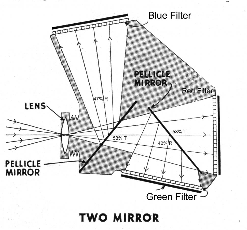

Hello to All,
It has been years since I made a pinhole image. My "specialty" is emulsion making,in-camera color separation and Platinum/gum on glass. But I have decided to push my practice to the limits by making Color Separations with a pinhole camera. Attached is a diagram of a Tri-color,one-shot camera, which I have. This is a 5x7 camera which contanes 2 pellicle mirrors. The light from the lens takes 3 paths and is filtered through one of three Red,Green or Blue cut-off filter. The distance from the lens to the red filter is 12 inches with the bellows totaly contracted.
My question is:What is the MAXIMUM pinhole diameter that can still produce an image. I have seen nice pinhole images where exposure time is measured in MONTHS. I am willing to do this, or use strong multiple strobes.

Thank you Keith,
Sounds like I will need to do this using my monorail view camera. Not the "one-shot". I think that I will try the one-shot approach too. Just to see what happens.
Just a thought ,though. The cut-off filters on the "one-shot" are very close to the focal plain,not to the lens. Therefor, we are talking white light for most of the distance the beams have to travel.

I don't understand what you mean by"reflected 90 degrees from center. Reflected off of what?
I think that the first thing that I will do is to measure the distance from a single pinhole to each separate focal plain. Then use a pinhole diameter around the average of optimum for each. Then take some images with the separation filters removed (I am speaking of the "one shot tri-color camera). Then put the filters back in, Take more shots and examine how the different colors affect the images.

You are correct. I know that I will never get pinhole images as sharp as what I can get with a lens. But I have seen some images that wre taken with pinholes that are amazing as long as the viewer takes their origin into consideration.
For Evrybody,
I have been working with some of the online pinhole calculators, But their are signifigant diffrences in the "optimal" pinhole diameter for each wavelength, given a constant focal length.

Hello to All,
After reading all of these opinions, I think that what I will try first is to use the tri-color camera. I already have brand new pellical mirrors for it. So,as far as expense is concerned, the damage is already done. ($500 per mrror,BTW)
I will just choose a mid point wavelength, say 550. Then,, each film plain will be a diffrent distance from the single pinhole, so I will choose the longest for exposure calculation. I know the R/T vallues for my pellicals, so I will factor these into the exposure. I can see myself useing ND filters on the two shortest exposure calculations. Then I can have one optimum exposure for all three film plains.
I have no idea if this will work. But most of my work is experemental. Most of my time is dedicated to emulsion making and I am doing well to get one realy good piece of work in a year.

This I don't quite understand : isn't your camera designed to have the same optical paths in the three colors ? if it's so with a lens (to get three views of the same size and same focusing) then it's so also with a pinhole ?
Paul
Paul[/QUOTE]
Polka,
Of course, you correct. The diagram attached to my opening post in this thread clearly shows this,as dose the camera itself. So I am clearly working with one distance. If I eliminate consideration of 3 different wavelenghts I need only consider a pinhole of optimum diameter for 12 inches. This is the distance from the lensboard to film planes with bellows totaly contracted. But I will also get some pinhole sizes acurate fore some bellows extention.
I have decided to get some specialy prepared pinhole for this project. And to not use readily availible laser-drilled ones. I wish to do everything right for this project.
Bill
