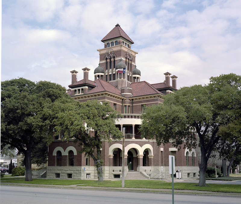

Thanks for the replies, one and all. I find that, at the moment, I'm partial to the old county courthouses in TX. I'm trying to get around to the ones I enjoy looking at and make images of them. My Crown does a creditable job; at least, I think it does. This is what I call a standoff shot.
Gonzales County TX courthouse by kenj8246, on Flickr
I'm just looking to explore a little more. I know only what I've read about movements but would like to be able to go further.
