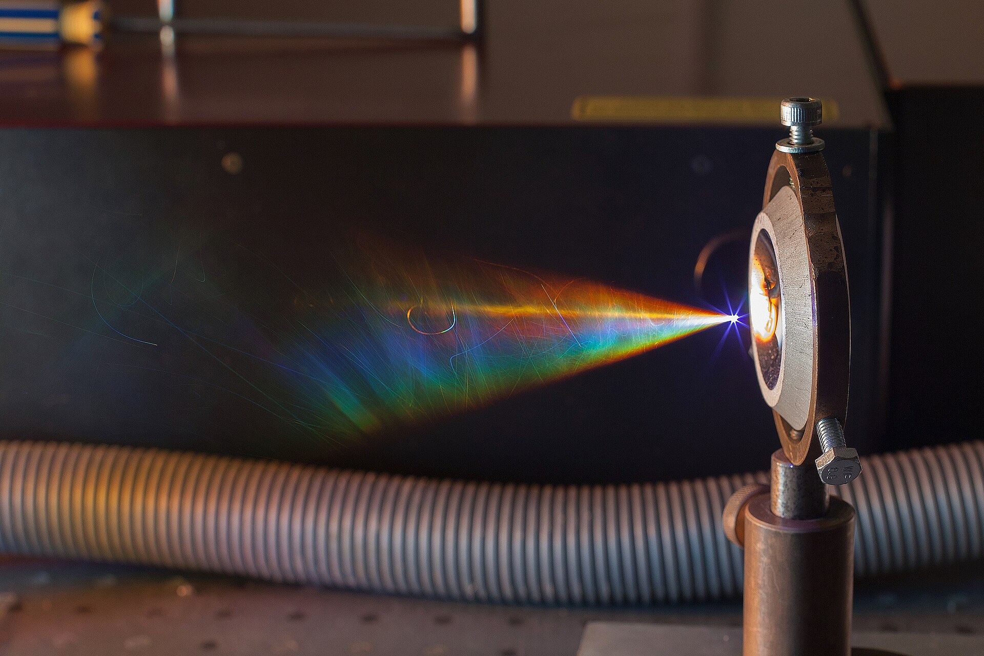

This is the future. NIR laser in full spectrum visible light out. Probably in a theater nearby. .
